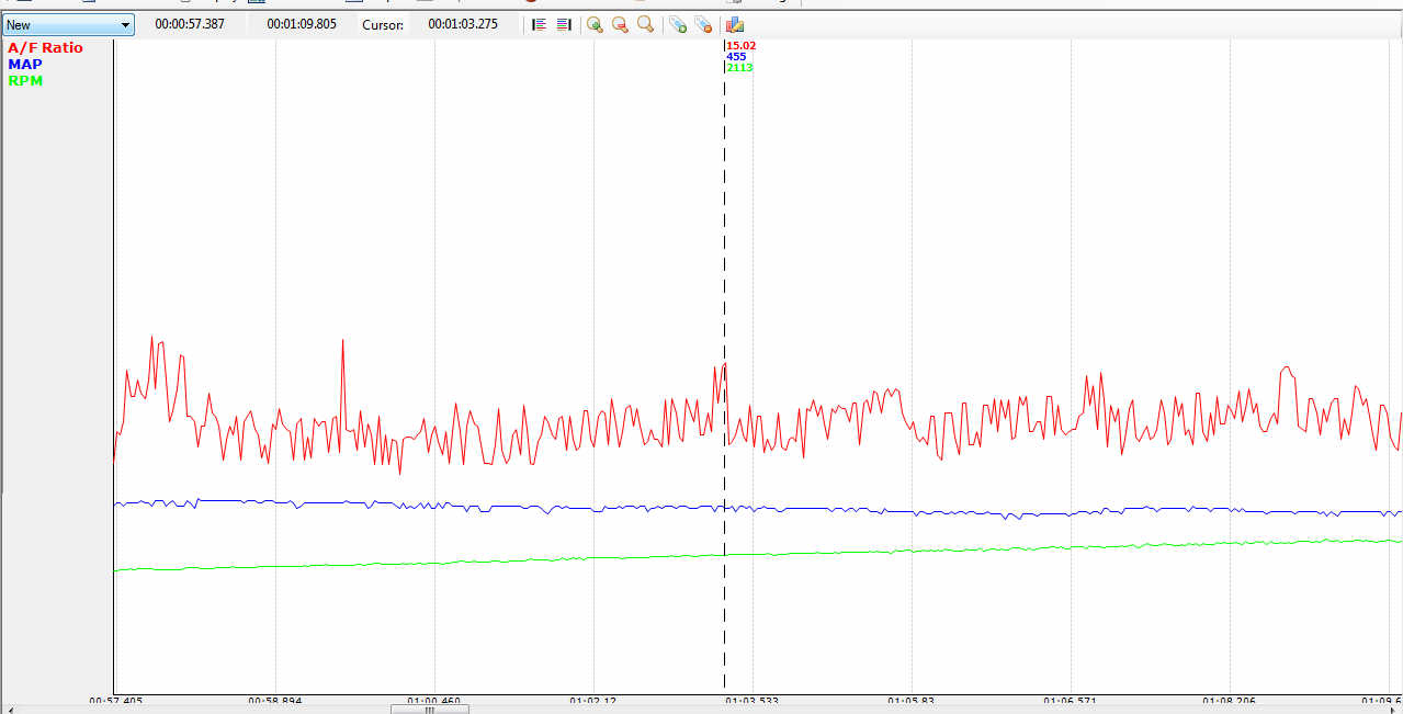

OK fuel pressure is rock solid. I have a log where my afr is just going completely nuts. I don't think its the wideband acting up because of all the other fuel related problems I have, but I am not going to rule that out.
afr fuckup_07072009_2128.elf
look at the log at 1 minute, you will see what I am talking about.
