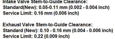

if you didnt replace the valve stem guides, the valve stem seals were pointless to replace. was the head redone at a machine shop or did the guy just replace the seals? if the guides are worn out and letting the stems walk around the seals are already destroyed. here are the specs.
valve guide spec
valve guide spec
type r valve guide service spec.JPG (28.74 KiB) Viewed 8852 times
