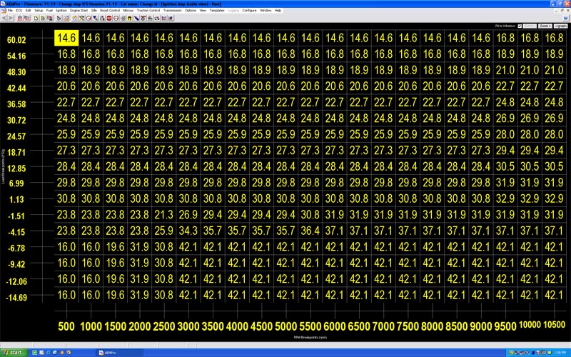

heck yeah. As long as its a built motor.. Q16 will take tons of timing.. Just work your way into it.. I'd start by adding like 2-3 deg at a time. A K series car on pump usually runs less timing than a B, heres the map on Q16 with AFRS at 12.8-13.0 This is conservative, I plan on upping the boost to 55psi, leaning it out a little more and adding timing once we get it to hook, right now we can't get it to hook in 3rd at 30PSI with 26in slicks..
LOL...on eCtune I might take a couple degrees out of that map on an efficient B-Series setup :)
You havn't done too many Q16 drag cars have you? lol .. . If you think thats alot, you should see the timing maps Chris Miller runs, or ask randy to send you the map from the RSTech integra.. your eyes will pop out lol.. The head on the RSX flows 330CFM, the motor comes out to 370CFM at 10500RPM, so its 90% efficient.. You will find it hard to get too much more efficient than that.. :)
