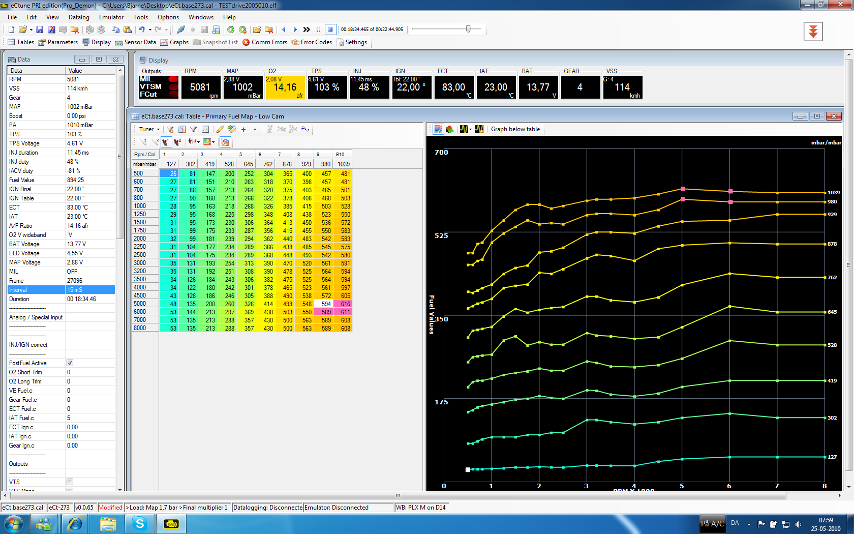

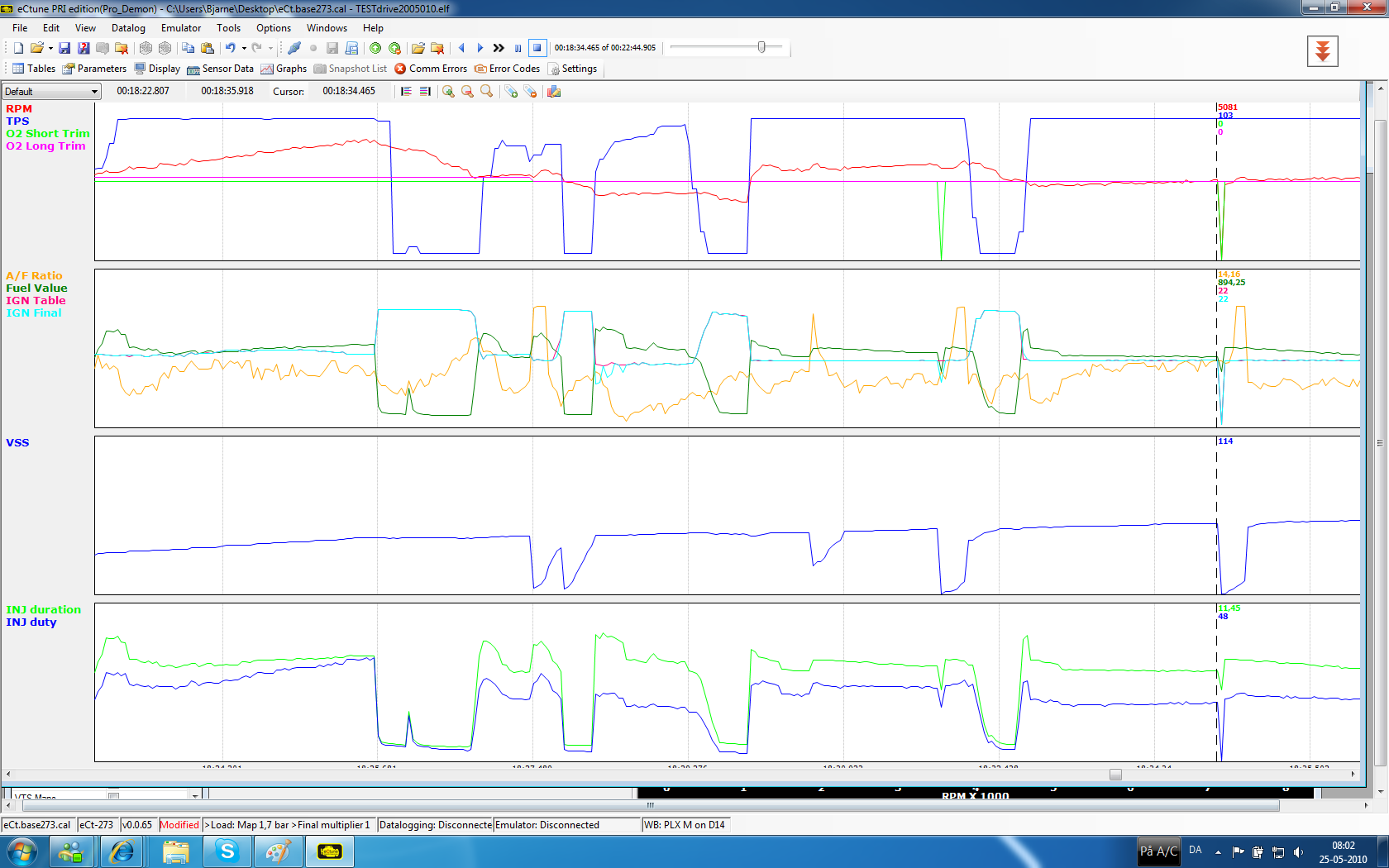

JaredKaragen wrote:I don't have access to my tuning laptop; or I would look.. But by description it sounds like the demon is resetting itself, or sending the ecu a reset command... The deamon from my gathering by now, seems to be suceptable to emi moreso than other moates products... Aftermarket wires could theoretically cause this, but I can't be certain without personally viewing the log; but my gut says it is the demon resetting and causing the 'hiccup'.
i have attached pictures of the graph and data for both frames at the frame where the value goes down, the MIL light goes on but doesnt show in data and no error code i sometimes have problems with the demon falling out when i datalog, last time it happend just after i stopped the log and saved it... then i have to replug the demon in the usb port to be able to use it again...
frame 27096.png (318.32 KiB) Viewed 10757 times
frame 27097.png (320.3 KiB) Viewed 10757 times
frame 27096 graph.png (230.92 KiB) Viewed 10757 times

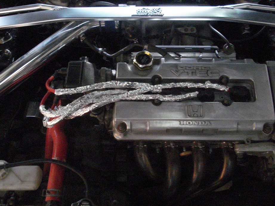

hmmm today i have unmounted the ECU and took off the top so i could see the diode on the demon while driving, i also made a little experiment on my spark plug wires... (tin foil covering the wires) so i went for a drive to test if the stuff had made any change, and i actually couldn't get it to \"jump\" like it did before.... the engine was running fine, but the datalog was not.. my ectune didn't refresh the numbers but the program didn't froze... it said it was connected to emulator and datalogger... and even when the car was in idle, i couldn't datalog for long :(

well after i put the tin foil on the spark plug wires, i haven't had problems with the post fuel / the engine jumps, so now i will try to see if the problem omes back when i remove the foil again... and if it does, i will go buy some new wires... have been looking a little at the magnecor KV85... are they any good? they claim to have good EMI proteciton... my biggest problem right now is that i can't datalog!! my demon connects fine on startup and emulator + datalog works, but datalog just stalls after short time.... anyone tried this, or got a solution for it? i have installed the 2 ferrites that come with the demon... i have an almost brand new OEM lambda sensor, so maybe i should try and use that next time... :) thanks for the respons!
