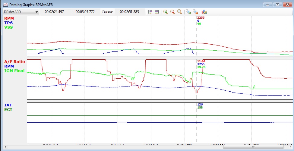

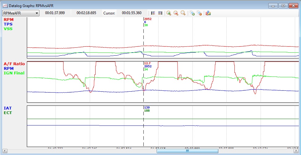

I am trying to tune out a rich condition during tip-out. It occurs during both an abrupt tip-out, and slow tip-out. Screen images below show both quickly letting off the throttle and slowly letting off the throttle. The cells that the map passes through during tip-out are all tuned between 14.6-15.0:1 in steady-state. I want to think that the tip-out trim percent adjust is not working since the same AFR's are shown during tip-out regardless of the value entered for tip-out trim compensation. Any tips/suggestions/feedback? Thanks for any help.
Abruptly letting off throttle
Slowly letting off throttle
this is normal... though there is an option to disable fcut and trim tipout.

Maybe I'm misunderstanding your post. Are you saying this is normal on eCtune? I've tuned many platforms before, and tip-in/tip-out can be tuned to keep AFR's at or around target. I would argue that it is not normal to have a rich condition during tip-out when the tip-out trim is maxed out to a remove as much fuel as possible.
If you try to correct out the rich tip out, you will cause driveability issues. Rich tip out is normal and needed to keep the car smooth during throttle transitions.
