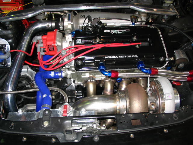

My existing setup: Image I'm going to change it shortly, setup will be the same but more bling factor :oops: :)
