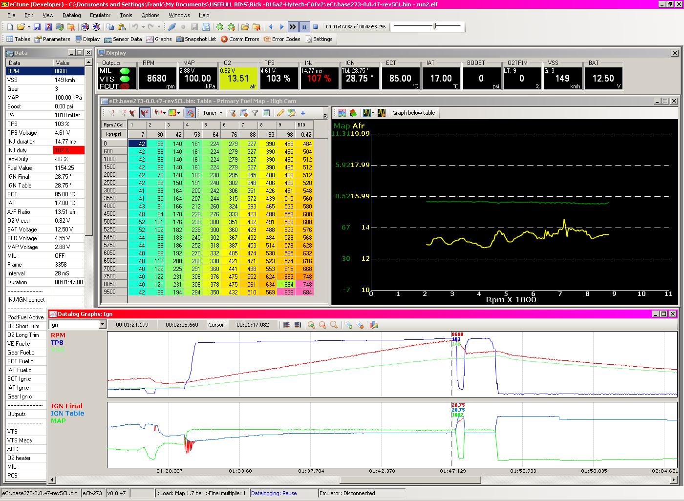

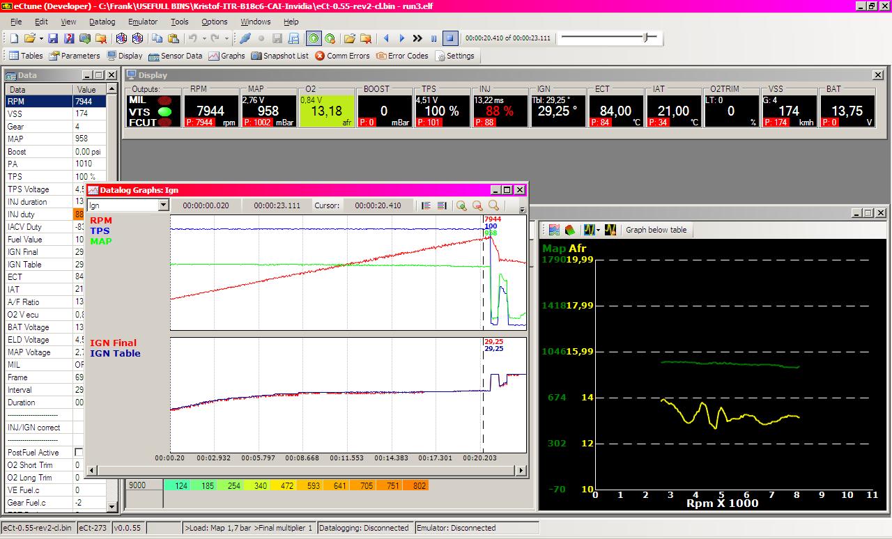

I know and you didn't, I just felt the need to explain that there are cases where going FI not only depends on us, unfortnetly. :wink: In relation to the itr im, i've already bought it (plus itr tb), maybe in this phase of the build i will only send the itr tb to maxbore.com and port match it to p30 manifold. I wll keep the p73 im to when i move to 1.8L block (poor man's itr engine build on sight) I only start thinking on upgrade the tb after noticed that map value was decreasing in top end, check graph: Image Goes from 1017mbar to 973mbar, around 5% loss. I think this means i've a restiction in intake system, although i still didn't test if the TB is the restriction cause or if it's somewhere before it. This occurs in every car? can be minimized? (dont tell me to boost it :P )
did an ITR today with these numbers: 1002mbar @ 2600rpm dropping to 950@8000rpm so thats also about 5%. Car had a CAI from AEM and a desent 2.25\" exhaust. I have a stock B16 with a ported 65mm ITR TB and intake manifold in my car right now. I can test if you want.
Stock B16c6 with AEM CAI and 2,25&amp;quot; exhaust
Stock B16c6 with AEM CAI and 2,25&quot; exhaust

I tested a other interesting B16a JDM with very nice ad-ons. It had a Hytech header, PerformerX manifold, 65mmTB, CAI on a stock engine. Interesting to see that the vacuum almost stayed the same during the run! This guy HAD a ITR manifold and a 70mm TB, but bought the PerformerX and 65mm TB. Peak power stayed the same but the mid range was a lot stronger. Nice manifold!

Image Uploaded with ImageShack.us Injectors capacity seems to be exceeded. Is everything in the injection system totaly stock(oem) ? Did you notice the same tendancy to injector limitation without the performer X?
