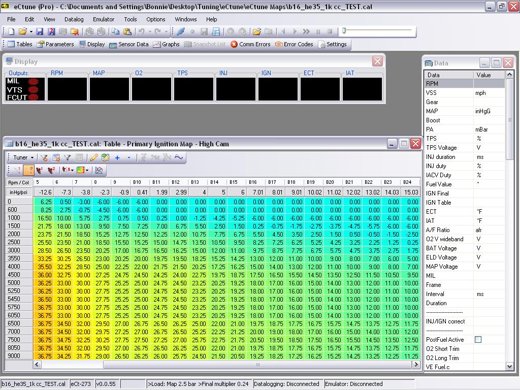

thanks for the help. i'd post my cal in here if it didnt look like shit from me messing with it all the time yesterday. ill go out wed. or thur and clean it up some. to clarify some things, that map you saw is from my old setup. i added some timing when i was at the dyno. graph was a little jumpy at the top end and adding timing made it nice and flat. on this setup im running nearly the same timing numbers. so its no higher then 16.75* anywhere around 12psi. plugs look like im running lean but i think thats do to the ignition cutting out. :?: im dead tired right now, so the car will have to wait until tomorrow. -EDIT- timing is setup up like this; p30 map, step retard 0 - 3 = .25* 3 - 5 = .50* 5 - 7 = 1.0* 7 - 12 = 1.0* 12+ = 1.0*
So are you still on e85? Can you post up a quick screen shot of your high cam timing map for us if you dont want to post up the file?

yeah still on e85. here is the shot.
I would definitely be moving that timing up. With e85 and 12 psi on a stock b16 I usually start at around 20 degrees and work my way up from there. Thats about a .5 degree per pound retard or so. the 13 degrees you have now is way too low.

im sure it is but wouldnt it have done this all the time ? ill try adding 1-2* and see if that helps any. i remember when i tuned it the first time on e85 the timing mark on the plugs seemed to be right in the middle. maybe a few degrees retarded but nothing to terrible. :?
