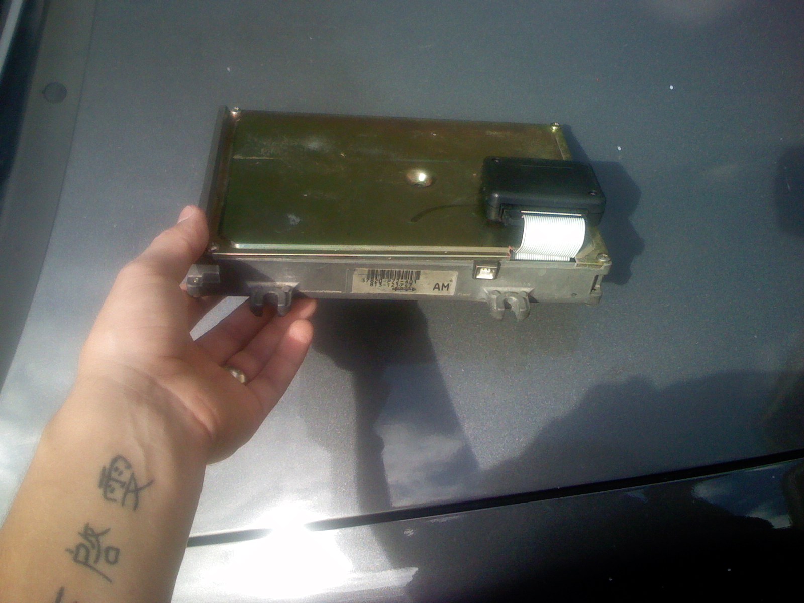

all the random things like this that I was having stopped when I packed the ostrich ribbon cable tightly inside the ECU with just the plug sticking out the side like 1/2in so I could plug it in. Also I use the hondalog and its perm mounted inside the ECu with jsut the connectors poking throiugh the side.. I'll take pics in a sec and post.. Also I updated my firmware on my LM1 and the issuses I was having with logging innovate have gone away so far.. Be back with pics ..
ECU
