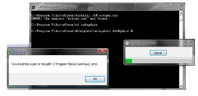

Tried to play with eCtune today, and found out I was lock out I needed the newer version, so I'm like ok this wont be hard its always simple, well I ran into problems after running forceupdate (which took longer than usual). I do get the window that say I've been update to newest version(0.0.2.2 r4)... so I go ahead and start eCtune back up and it gives the same message \"MSGID M002H Old Version! Please run force update from start menu to get the latest version.\" So after doing that over and over about 6 times i uninstalled eCtune downloaded and installed a fresh copy and i still got the same message whats going am i doing something wrong.. also notice that when i run force update
What I get when I run forceupdate
press OK.. it should continue normally

calvin wrote:press OK.. it should continue normally
I do.. after it loads tells me its been successfully updated to 0.0.2.2r4 so i start ectune and i get this message
this means... drumroll please.... you gotta wait for the new version to be released... check the site for the post int he software support section with release comments on the new version; or just forceupdate on the day listed in the program.
