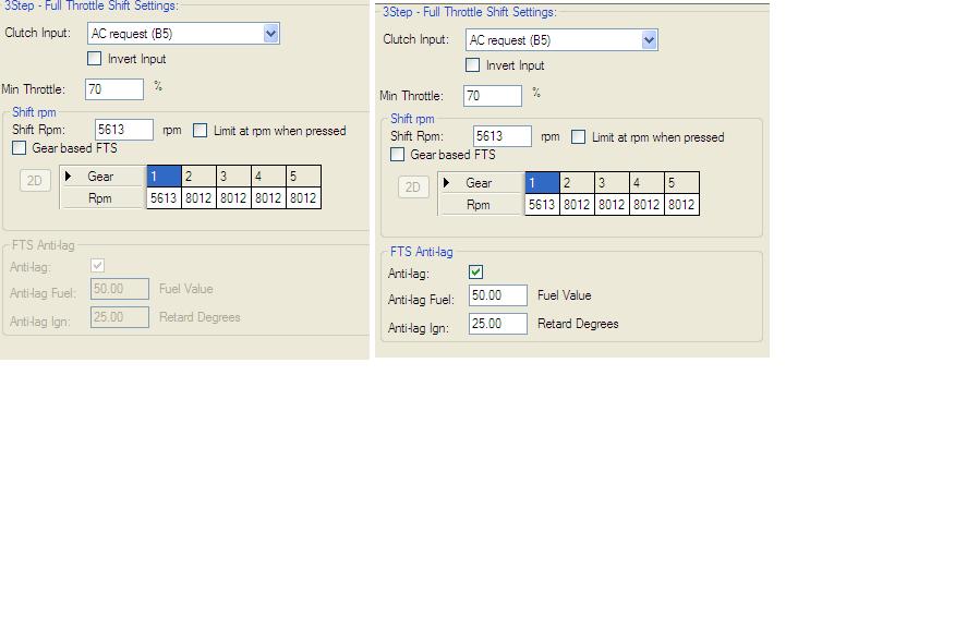

I had a chance to messed around with the FTS tonight and ran into a lil bug. When I choose a clutch input, the antilag will un-grey...But when I exit parameters and go back in anti-lag is greyed out until I choose a different input then it will un-grey again. Also: Since I'm using the cruise control switch as the input, I would need to check invert input correct? because switch is pressed in when I'm off the clutch and would depress when I press the clutch.

bug is still there, I forced update and it says updated to version r7, but when I open ectune it says r8.
i see fts anti-lag bug fixing and uploading
