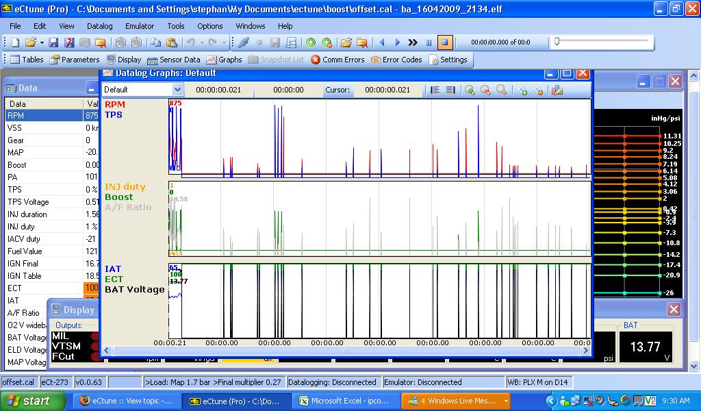

Im not sure what is happening But when i replay a datalog, i get VERTICAL lines

Here is a scr shot
pic

Post by elevation »
ground problem?

b20beast
Posts: 224
Location: Trinidad
Post by b20beast »
grounds seem fine double checked them
Synoptic
Posts: 312
Joined: Wed Apr 04, 2007 11:48 am
Location: Montreal, Quebec
Post by Synoptic »
Number of sample per second is too low.. so you do not datalog enough.

b20beast
Posts: 224
Location: Trinidad
Post by b20beast »
sample update delay is 4 stack size is 100 min samples is 50
i'll show u later ecu is reseting or u using a bad datalog cable(nokia perhaps)
