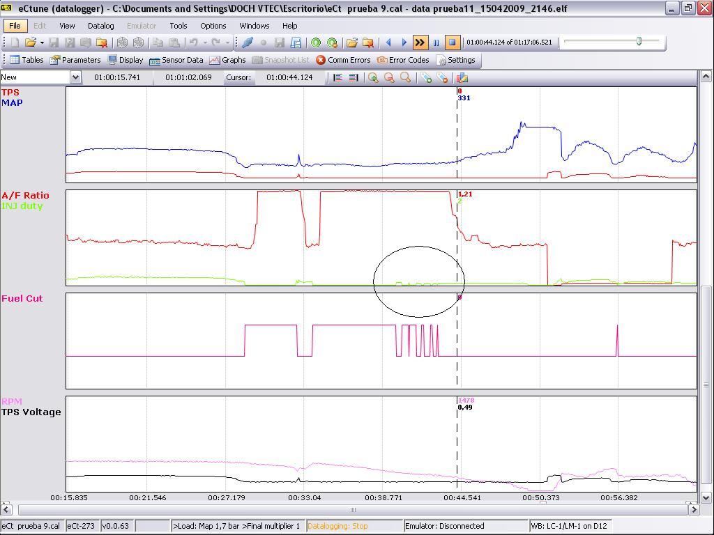

hello, I have been doing several tests with the update that calvin send me. I've also tried several setups.y the car now goes well . now I can only adjust the area tipout at low revs and this one little rich.i think that if this new routine includes the problem will be solved for all

I have a question.why these pulsations appear in the duty cycle?
Adam Hopkins
Posts: 283
Location: Murfreesboro Tn
Post by Adam Hopkins »
Because it is coming out of fuel cut and firing the injectors
Regards, Adam Hopkins eCtune Team eCtune Authorized Tuner Location: Murfreesboro, Tn, USA

Hi, I noticed a small voltage pulse in my tps.could be that this is why the pulse duty.maybe that the fuel cut routine works only when the minimum reading tps,and not in the voltage range of tps.

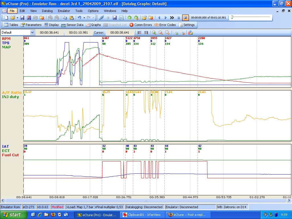

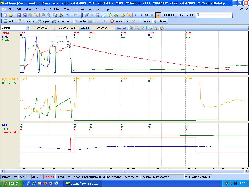

I had the same problems with fuel cut switching on and off during decel. I did a pull and found min mbar values around 100 (min 90), TPS 0, fuel cut on/off. Fuel cut settings were TPS 5%, mbar 149. Then I played with these settings and did some runs in 3rd gear. When setting the TPS 0% and mbar 100, there was no fuel cut at all. Now I have set the TPS at 1% and mbar at 200 and I have steady fuel cut during decel. Problem solved :D
crx303
Posts: 55
Joined: Thu May 03, 2007 3:45 pm
Post by crx303 »
Before

crx303
Posts: 55
Post by crx303 »
After. The first fuel cut spike is due to the rev limiter (which I have at 7000 rpm)
