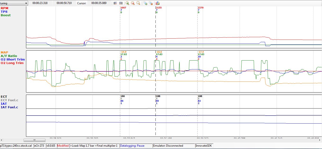

i just played one of your logs and noticed your afrs jumping all over the place. is this where your problem is? just curious
afr jump type r.JPG (116.01 KiB) Viewed 13276 times
The reason the afr's on the log look so erratic, is because the day I was datalogging, it was raining and snowing. Some water went inside the connection between the o2 sensor and the wideband gauge harness. I had another aem wideband do the exact same thing whenever it rained. I'll post new cal and log a.s.a.p.....
