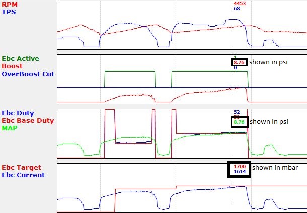

i have my units set to inhg for vacuum columns, and i have my boost columns set to PSI, now when i play back a log file and use the graphs, ebc current, and ebc target are still shown in M bar while boost reads PSI and MAP read vacuum/PSI. yet when i play back the file and watch my data bar, target boost is still shown in PSI, why is this? can i change it somewhere? it just throws me off a bit, it would be easier if it read in psi, at least for me. can this option be added to change the units of measurement in the graphs?
ebc hmmm.JPG (71.36 KiB) Viewed 30554 times
Logger version doesn't get the rom as posted here: http://forum.ectune.com/viewtopic.php?t=2235
