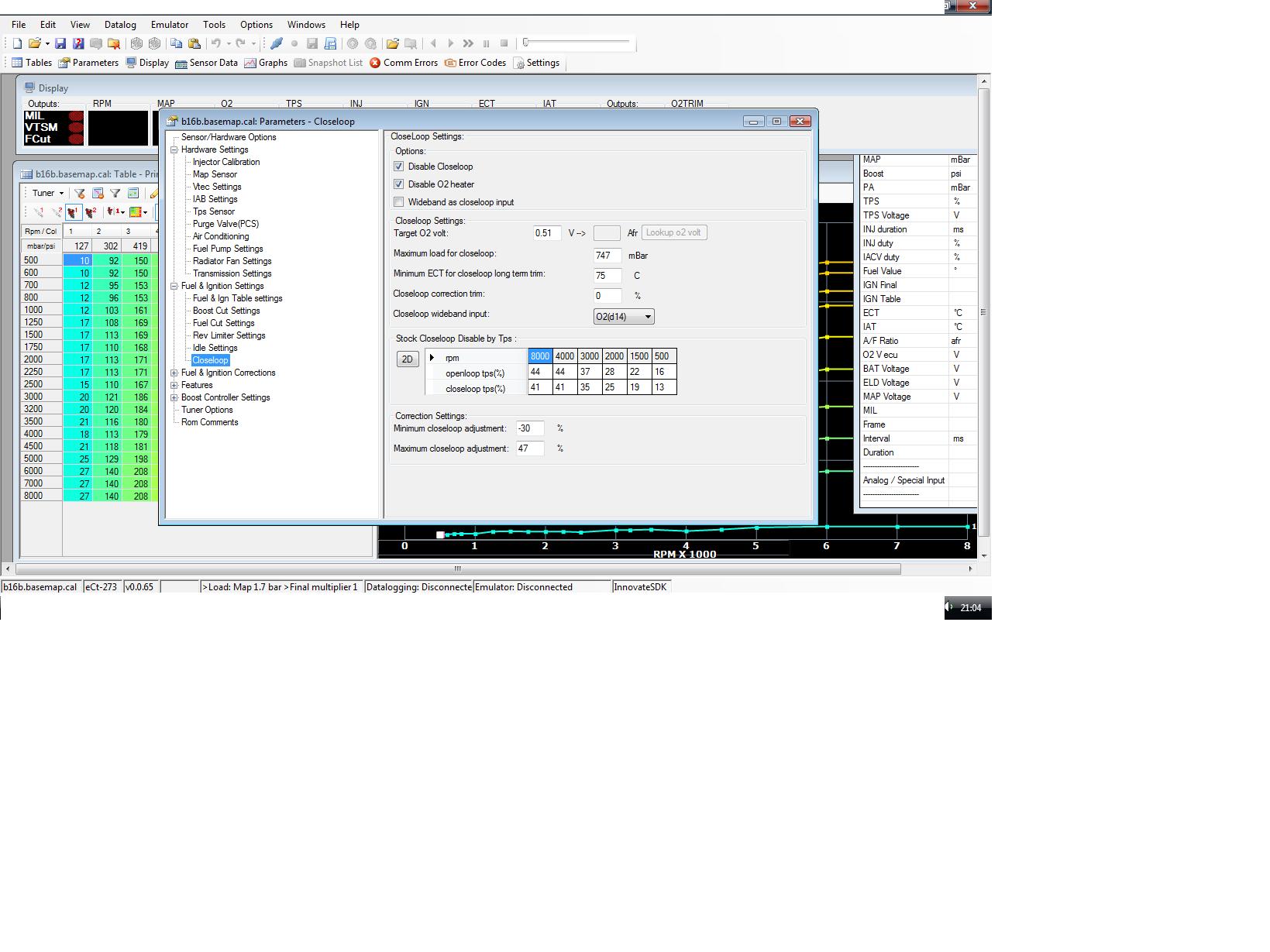

You can disable 02 heater under fuel and ignition settings, closeloop. Check screen shot i attached.
Screenshot
Screenshot
FYI after tuning I was able to get 42mpg @90mph for a whole tank of gas.... Running open loop. I personally don't like the fact that the ecu has to go rich and go lean every few milliseconds, that's wasted fuel IMHO.... But it took a few months of light throttle street tuning to get to that point.
sIrK
Posts: 88
Joined: Mon Mar 08, 2010 4:24 am
Location: Barcelona
Post by sIrK »
I have marked the \"Disable O2 Heater\" and \"Wideband as closeloop input\" because i have only the uego installed as o2 sensor. I show you my settings (Wideband input is in D12 because in red civic have installed in D12 and in grey(Turbo)civic have installed in D10): Image
