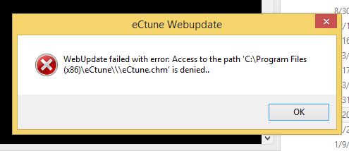

JaredKaragen, I don't suppose you have any insight to why I'm getting this error (I have attached the image). I'm running Windows 8 and can not seem to get Ectune to force update. I have the latest version uploaded. Thank you
ectune error.png (8.85 KiB) Viewed 524420 times
Follow my posted steps here. It requires that specific workflow to get going. Something from win7 and on changed the way permissions work; and ectune is tough to get around this. be sure to do EVERY STEP from an elevated command prompt and it should work fine... but the forceupdate reported success; but only changed files in the AppData/Roaming/in4tec.... folder. I had to install using the installer; forceupdate download/install the update manually (from first thread in this forum) forceupdate again from elevated command prompt... then it worked. Hope it helps!

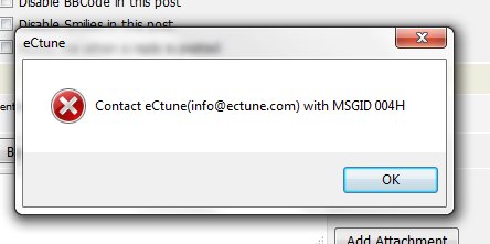

JaredKaragen, I have uploaded ectune successfully to my old laptop but I have now have ran into another problem. I am getting error \"MSGID 004\" when I try to run ectune. I have searched and it seems as though there is an issue with my license and laptop hardware. (http://forum.ectune.com/viewtopic.php?t ... msgid+004h) I am using the same laptop that I have always run ectune on, but, the laptop has been formatted not so long ago and now runs with windows 7 (instead of Vista). Do you have any suggestions? Thank you again for your help, it is much appreciated.
004H.... ok, I think its still out of date, or license expired/wrong. did you do a Win10 upgrade? if so, did you start the license registration process from the beginning for a new license on the new OS? I think all the errors I was getting for old version were 002h.....

JaredKaragen wrote:004H.... ok, I think its still out of date, or license expired/wrong. did you do a Win10 upgrade? if so, did you start the license registration process from the beginning for a new license on the new OS? I think all the errors I was getting for old version were 002h.....
No, I have windows 7 on the laptop I am using. When I first installed ectune I had windows vista though, so I'm guessing that's what's now causing the issue. I have tried going through the registration process twice now with no luck. I'm guessing someone needs to link my laptop and license together (on the ectune end). Do you know who could do this? Other than that, the program itself opens and runs fine.
That makes sense. when you change OS the license for an ostrich will need to be updated. So you basically do a clean install; update it to the current version.. Then in the \"Help->Registration\" menu fill it out as before. Once that is submitted, you will get an automated email letting you know the submission was successful. After that, PM gaskleppie on this site, and let him know you need your license updated. You will get license.xml in the mail. save it to your desktop first, then manually move it to the ectune folder. ectune should launch and run. Just hook up your ostrich, and in the ostrich/emulator info menu, \"Request license\" and it will re-vendorize your ostrich. Should be good to go from there. eCtune's license is sensitive to system changes (HDD, OS, network cards, etc.), so this is why you would need a new license.

I have a new computer and just installed ectune on my windows 10 think pad yoga. I did a clean install and tried to force update but I get an error saying \"Access to C: program files (x86)\\eCtune\\\\\\eCtune.chm denied\" What am I doing wrong?

It's something about Windows not allowing you to update what I did to get around it was to install ectune on an older pc running vista and did force update then saved those files on a flash drive then just replaced files in ectune folder on new laptop running Windows 10 and it worked I'll try and attach those files later when I can get to my flash drive so others with the same problem can fix it easily

Thanks Jared for the info on getting it up and running. I have a different method that I used to get ectune working on my Win10 laptop. Based on the same steps that Jared used, however easier IMO. Download eCtune via the link in the current version thread. Run this program as admin Open whatever directory that it installed to, usually Program Files (x86) Right click on eCtune folder, click \"Properties\" Under the \"Security\" tab, click \"Edit\" (Change permissions) Click your logon name under the \"Group or Usernames\" menu Next box down \"Permissions for ALL APPLICATION PACKAGES\", click Full Control > Allow Click ok to exit all the settings prompts. Start menu > All apps > eCtune > Force update This should allow the update to proceed. Get new license(if needed), place in eCtune folder, run APP as Admin( I simply open properties and make it run as Admin every time)
