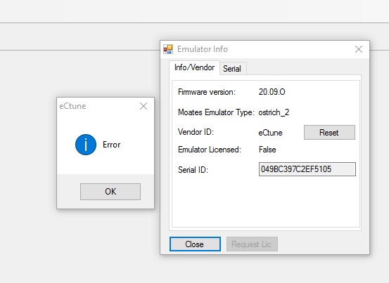

Just installed fresh to a new laptop (win10). Got the license a few days ago. Now when I want to connect the ostrich to ectune. I push request license and I'm getting a screen which only say's error. Is a bug in the software or something windows 10 related?

just uninstalled ectune, followed youre steps exept that i did step 15 before I paired the ostrich otherwise ectune tels me it can't detect a demon. Got the license can connect to the ostrich but keep getting the error screen on requesting license

Probably miscommunication on my behalve, I have a ostrich nota demon.I'l try to explain what ive done When I install ectune fresh it says Pro_demon. I have a ostrich so before I can even enter the \"moates emulater\" under the \"emulater\" menu to connect to my ostrich and request a license ( step 14 in youre 17 step program). I need to register under the \"help\" menu and registration button (step 15) I did step 15 a couple of days ago en got my license. Now i copy the license to the ectune directory en then when i start ectune it says that i got the pro ostrich version. But when i want to use the ostrich it says: Ostrich not licensed or vendor not eCtune. so i go to emulator info and click the request lic button and then i am getting the error screen. But I think its something to do with windows because i tried to request a new license for test purpose (step 15, filled everything with test) and got the message that a new license was requested. closed ectune and restarted ectuen, tried to request a license again with my own credentials (also step 15) and got the same error message. Its like somthing is blocking ectune to perform a license request
