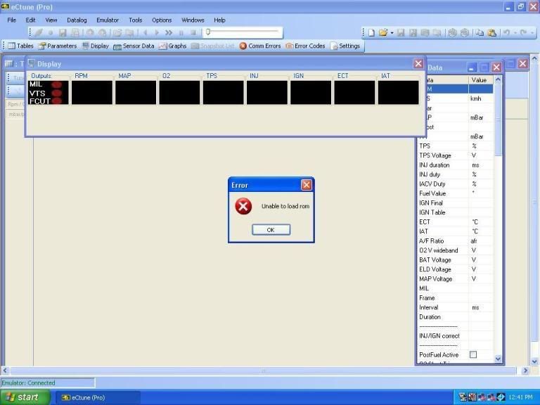

Ok, I verified my ectune verison and it is 0020 r4. To test the using Key On Engine off & TPS to check mil I tried to provoke 2 check engines. I disconnected the map and tps sensor. When I started up the car it did not give me a mil. I turned off the car, connected them back and started the car and pulled them while the car was running but it did not give a check engine either. I will repeat this again to do more testing. I decided to test the get rom and verify rom. I started up ectune and connected the emu. While ectune still had no calibration(rom) opened, I hit get rom and it gave me the error \"unable to load rom\": Image I had to re-open the rom (calibration) file that I had saved. I then tried the verify rom. I hit verify and it said \"rom did not verify\". I opened a new rom file, did a put base rom+ cal and then verify and I got the same message again. I will go through all the steps again tomorrow and see what happens. I was going to so some runs with the car but it started to rain pretty hard so I suspended it.
