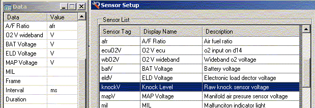

Hi, I'm beginning to test eCtune (Pro). One simple question, why can i not view the Knock Level in the Sensors Data Window? But I can configure it in the Sensor Setup Window. Thanks!

hehe yes it has knock board :roll: In the pic attached you can see the problem, there isn't Knock Level in Sensors Data window.
HONDA Integra Type-R #00809
MartinX3M wrote:hehe yes it has knock board :roll: In the pic attached you can see the problem, there isn't Knock Level in Sensors Data window.
It's removed.. i have to remove it from the sensor list.

Won't it be included anymore?
not for pro

I know it nate 8) But it result me strange that i could see the Knock Level in the Sensor Setup Window, but not in the Sensor Data Window....
