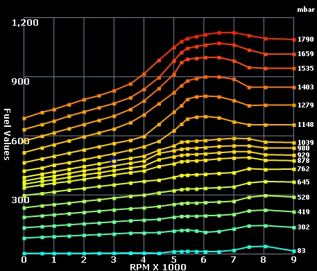

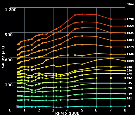

One thing I did, is get WOT in the area, then, select the map from WOT/MAX boost to max vaccum, then click \"Interpolate row values\" and do a little tuning, get some areas to the respective amount; then interpolate row values again between the above and below areas tuned... Maps turn out nice. Check my D15B MAP in the other forum I posted, I will go right now and upload the .BIN I am using right now; and you will see these little ripples, or wakes; results of not doing the injector battery offset tables completely at-first with this tune. Here is a screenshot: Image You can see where I interpolated everything, then moved the rest around to be respective to the tuned portions of it; When I want to further my tune, I try to hit the non-rippled spots; and smooth them out more. Now; Look at the Hi-Cam: Image Obvious what was done. Should help alot ;) Calvin, maybe there is a way to have the program select the groups of cells by a buttonpress? Lets say the same Idea as above, maybe click on the cell with a % value you wish to change; then click a button that will \"select like percentages\" on the map so you can adjust; Example: Click a cell that is -6% fuel, Then click the button and it auto-selects the other cells in the map that require a -6% also. Maybe in the Settings panel have an option where you can choose the range for which it highlights cells (above x millibars and below x millibars) so you obviously ignore and not select erroneous readings near full vaccum, etc. Unless there could be another auto-adjust button with this feature built in... eliminate an extra click ;) One for singular adjustment, one for like adjustment.
D15B LowCam
D15B LowCam
ECTune 042.jpg (138.64 KiB) Viewed 11077 times
D15B HiCam
D15B HiCam
ECTune 043.jpg (150.35 KiB) Viewed 11077 times
