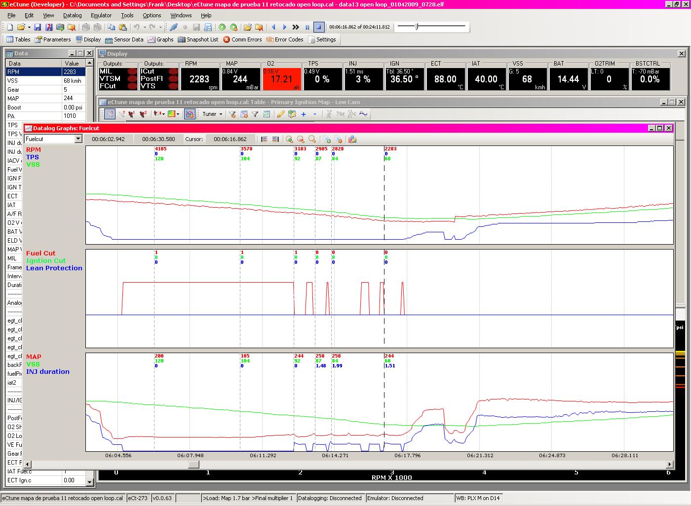

darkb16a1 wrote:I have exactly the same problem as racepak. Drive out - WOT - watch the mbar values from approx 6K RPM up to 2500. Values are somewhere between 160-210 mbar. Set the fuelcut to 220-230, TPS 1%. When RPMs are around 3000, fuelcut stops working and car starts to jump. So I raise the fuelcut baro value a bit, but then when I'm very gentle on the throttle, fuelcut somes in play as the baro values are below minimum level even though I am at 5-6% of TPS and trying to drive slowly in the city. Calvin, I really think the best way how to solve this is to completely disable the MBAR value for fuelcut - for example by a checkbox. Then the only thing that would define if the ECU has to do a fuelcut would be a TPS value and minimum RPM. I was also using Crome before, also no problem and honestly, since the ride is so bumpy, I am using Crome right now even though I hate it comparing to Ectune.
I have been reading back what has been written here to see if I had left some details, my problem is the same as this, I have tried everything you have told me, putting the 75 mbr fuelcut the car does not change, the problem remains .he made to observe the test and around 3200 rpm on the fuelcut is lost even if the tps 0
data13 open loop_01042009_0728.elf
(2.83 MiB) Downloaded 482 times
eCtune mapa de prueba 11 retocado open loop.cal
(8.19 KiB) Downloaded 425 times
I still think that your mbar settings are too low. See this pic from your log. The mbar goes up when the revs go down.

hello, I've been testing these days, I tried to make the cut in 280mbr, but there has been no luck, still the same bug, only now some 2800 crashes rpm.i reinstall my ectune, in case something in the program bad, I have updated to version r9, and now I can not put the selection of tps to 0 because the option fuelcutstops working.look this log, I'm desperate to get it running smooth under the 3000rpm.thnks
