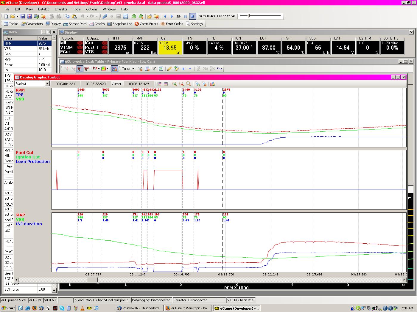

hello.i have been talking with the skunk2 people, and I have been told that these cams produce less vacuum at idle to stage 2, since their range is of a different design to be pro. take a look my. cal.arround minute 3:04, I made a deceleration from about 7000rpm to the 2500rpm .the fuelcut this is set to stock program settings,excep tps .you can see that the engine produces vacuum under the provisions and is not acting as the perfect fuelcut, even under the conditions chosen. please,take a look arround my .cal parameters,might have something that is not well in my setup or not that happens, all requirements for fuelcut but no fuelcut, or when there he want.no understand why, or if there is anything that this hindering

Still I think that with a vacuum setting @ 200mbar and looking at the graph, I think the ecu is doing quite what you have set in parameters. You have to consider that there is a 600msec delay also. Like you can see in the graph, its cutting below 1% tps AND below 200mbar.

between 2800 and 4800rpm, you can see how the map reading is always in this set. only twice during this current time.i understand that there is a delay of 600ms until the fuelcut, but during this period never exceeds the map value and no fuelcut.appears when he want.

red_zone wrote:between 2800 and 4800rpm, you can see how the map reading is always in this set. only twice during this current time.i understand that there is a delay of 600ms until the fuelcut, but during this period never exceeds the map value and no fuelcut.appears when he want.
I understand what you are seeing but you must realize that the ecu reads much faster that the 15msec sample rate we can see in the logger. So were you read 200mbar or just below that, the ecu can have read a small spike above 200mbar that have caused the fuelcut to stop. I dont think the ecu wants to punish you just because you placed a set of Skunk2 cams in his engines head ;) But, looking at your graph, it could help bigtime if Calvin could make some sort of Fuelcut off-delay. Maybe its possible, just as the fuelcut on-delay to make such a thing.
