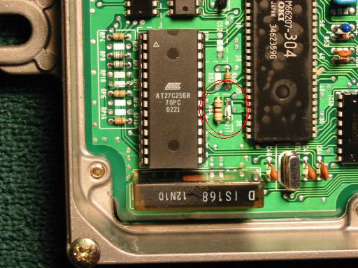

When J1 is ON (with a jumper) the ecu use the ROM in the socket not in the OKI if J1 is OFF(without a jumper) the ecu use the ROM IN the OKI

ok, then i guess its there, because i havent done anyting to the j1.
fireztorm wrote:ok, then i guess its there, because i havent done anyting to the j1.
take a look at

what type ecu is on the picture? usdm?

ok, i found the J1 it is without a jumper..
install a jumper and welcome in eCtune world :twisted:
Theres your problem, simple enough. Just add the jumper back in and enjoy eCtune.
Garrett wrote:install a jumper and welcome in eCtune world :twisted:

When an ecu is chipped, it is assumed that the jumper is installed. By not having the jumper, you are are running off the factory settings so technically, you are not chipped.
