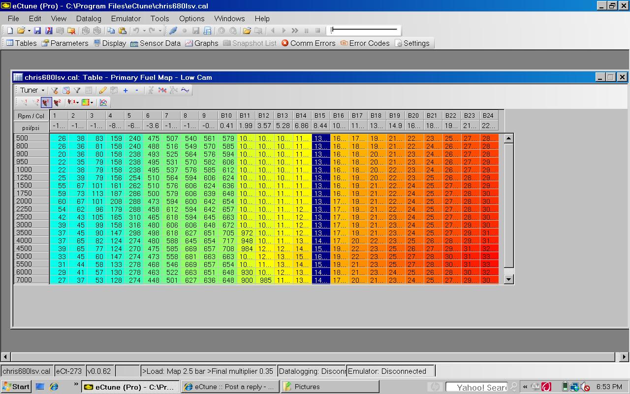

i cant get rid of this \"evil x\" and i can only see one column of values
pls post a screenshot. but yes your ostrich has to be licensed

i got ectune working some what but i have an issue.....i cannot see some of my values here is a screen shot[/code]
