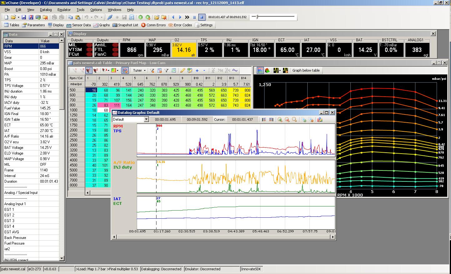

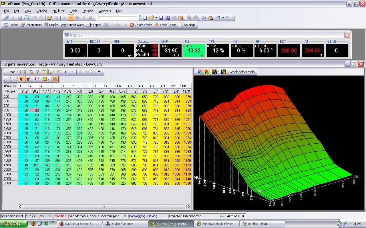

screen shot
OK hears my screen shot. i figured it out
ect screen shot.JPG (239.76 KiB) Viewed 8954 times

Looking ectune does not have live graphing. i'll open your cal and log and post screenshots
everything is working. playback and graph review see attached
