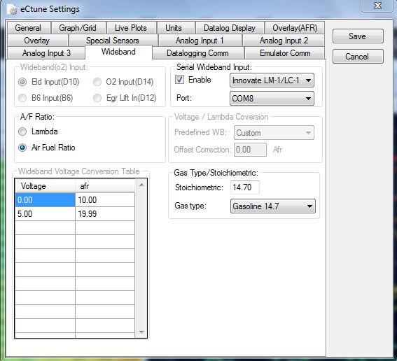

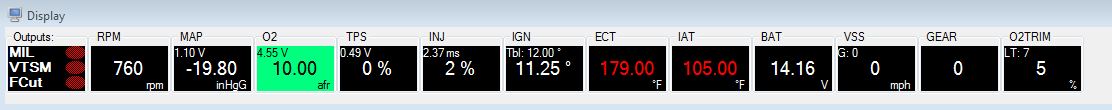

ok so i just got a lc-1 setup from chris at xenocron and i am using a iogear serial to usb converter and i have everything set in ectune how it should be i think and it is not working, it says in wide band bar 10.00afr and 4.55v?????? if i open logworks it is reading fine there. ive read a couple of post saying make sure that everything is connected to your comp before starting ectune and i did, i tryed switching the wideband in wideband settings and save,close ,open back up and switch back to innovate lc-1, save and close and it still is doing the same thing. but it works fine in logworks.. what is the deally o?????? some one please help!!!!!!!
wide settings.JPG (56.83 KiB) Viewed 2382 times
wide not working.JPG (31.8 KiB) Viewed 2382 times

ok nevermind, i got it working. update firmware on lc-1,(well not update, reload i.e. clean install), have everything closed and turned off, plug in your ostrich, and hulog, and serial to usb wideband,turn key to on position, open and start ectune, click connect datalog and emulator, start car, and working. those are the steps i had to take to get it working right. so just if anyone else has this same problem, here is the steps. _________________
