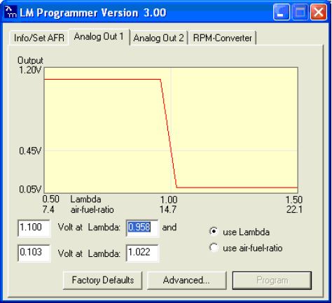

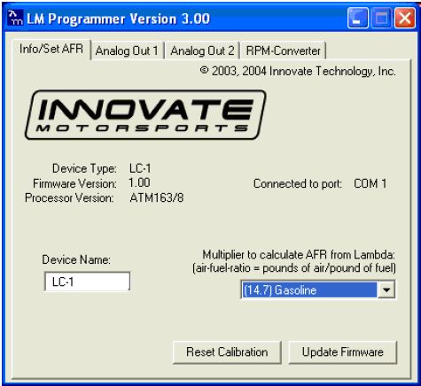

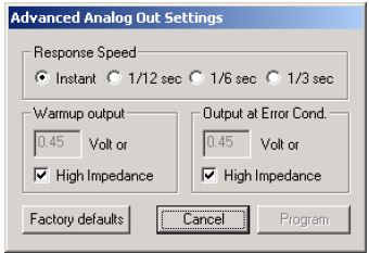

aem does not come with a serial plug, you would have to wire it up to a db9 serial connector, but there is no software to configure it. innovate has software to configure latency/speed, operation, analog outputs times 2. ect. ect. ect. oh ya, and you can free air calibrate the sensor, so if you think it is reading wrong, remove it from the bung and expose it to air and calibrate it, put it back in and you are good to go. i am not a rep for innovate, but i had a aem unit for 3 years, and ever since i have had ectune it has caused me nothing but problems, the entire time i was tuning with the aem unit i was running way rich, better than lean but still. now that i got my innovate lc-1 my car runs great.
inno 2.JPG (40.45 KiB) Viewed 11011 times
inno 3.JPG (25.62 KiB) Viewed 11011 times
Inbox :: Message From: calvin To: jpjackson Posted: Sun Dec 20, 2009 10:41 pm Subject: Re: which wide band do you recomend with your software??? I recommend LM-2 or LC-1 LM2 has native USB LC1 you will need serial to USB converter. _________________ Regards, eCtune Team eCtune Authorized Tuner Location: Caribbean & Suriname aim:calvinPGMFI skype:ectune We remote connect to your laptop if you have problems. Best support in the world. this is a quote by Calvin himself, when i found my aem to be shitted out i pm ed him asking which wide band he recommended with his software, and this is it. he created it, so i think he knows what works best with his software.
