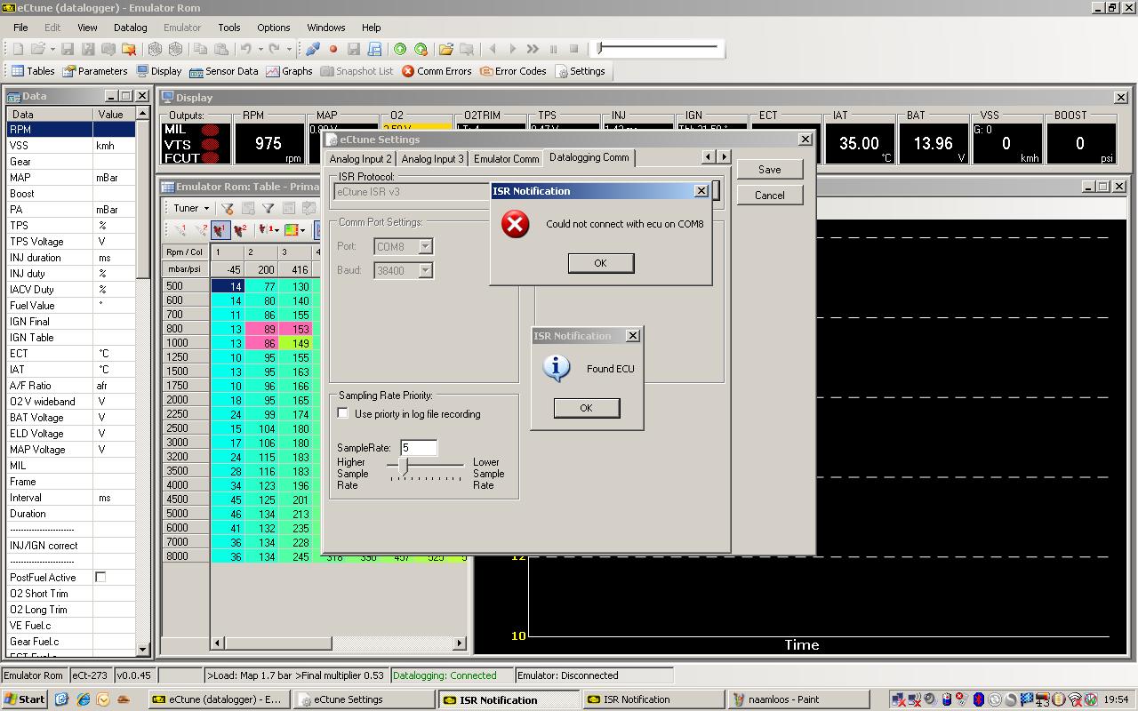

blundar wrote:Bug #2: 1. Key on 2. Datalog.. Connect (works fine) 3. Key off 4. Datalogging still says connected, but no data comes. 5. Key on 6. Dataloggins still says connected, but no data comes. The bug appears to be the datalogging connection getting stuck. If you click Datalog..Disconnect then Datalog.connect, it will start working again.
Having this exact problem with the Force Update version r7. If you click test in eCtune Settings menu an error message apears (see attached pic). After that Connection works normal again. Shutting down and restarting eCtune also does the trick.
Error
Error
fixed in 0.0.2.1> which will be released really soon

well code wise nothing at all change just the exp date. So i would say laptop/related. Try a clean install
