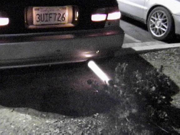

yeah I see what you mean, but I know it can be done through the antilag routines, it's just the revlimit bug after the first backfire... it causes the revlimit to be constant as-if no resume is present. I still haven't been able to 1394 the video, but I dug up an OLD ass peice of hardware: Sanppy Video: USed the paralell interface to download a snapshot: Image
cool. looks like u got a lite-saver sticking out ur exhaust
lol, yah, it's pretty sweet looking in slo-mo... makes me want to get a high speed camera for a good slomo shot... I just wish the vid could be there; you can totally hear what is happening =P but the video doesn't come close to showing you how loud it really is; maybe if I can get a DB meter to get a reading =)

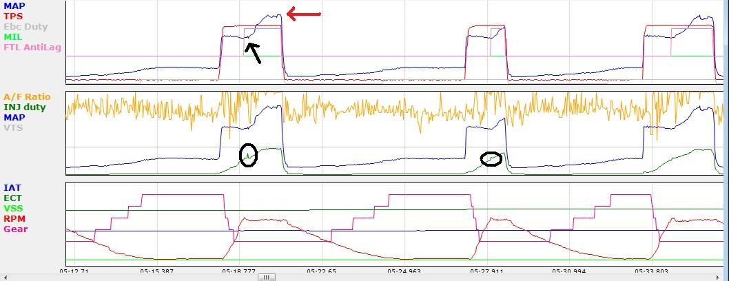

Ok, attached is a cut from a couple Antilag tests; I was trying less timing the farther down the right. the 2 black circles are about the point of the backfire; I only found them in the log when I got a good backfire. The black arrow is the point of interestl just shortly after the pop; the huge increase in boost (at 5,500RPM FTL) The red arrow points to where it starts poping again; and it doesn't work as efficently as seen in the boost levels.
ECTune 029.jpg (70.66 KiB) Viewed 12026 times
