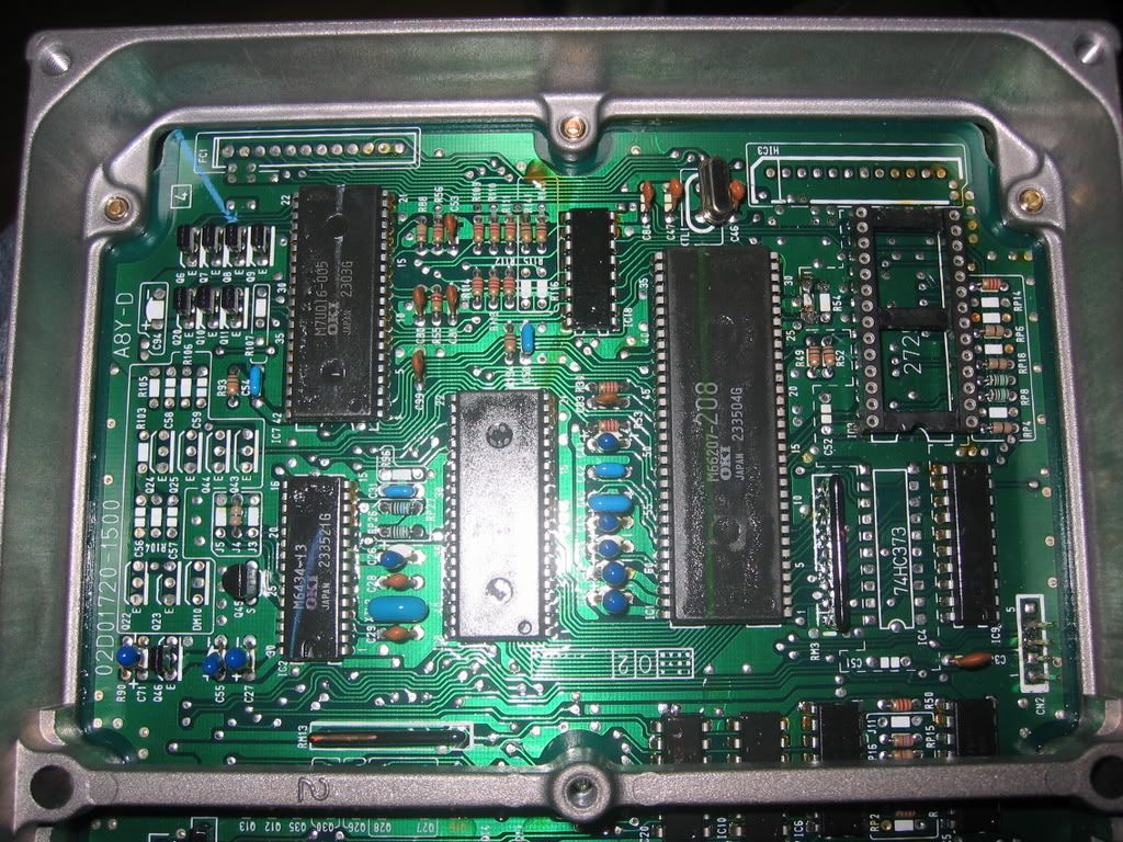

on the picture you sendt later in this post about the J1 i can see that you have a 304 number on your OKI. and the map in ectune is named: stock p28 304 USDM map. on mine OKI is stands: 208.. is this right?
fireztorm wrote:on the picture you sendt later in this post about the J1 i can see that you have a 304 number on your OKI. and the map in ectune is named: stock p28 304 USDM map. on mine OKI is stands: 208.. is this right?
it doesn't matter

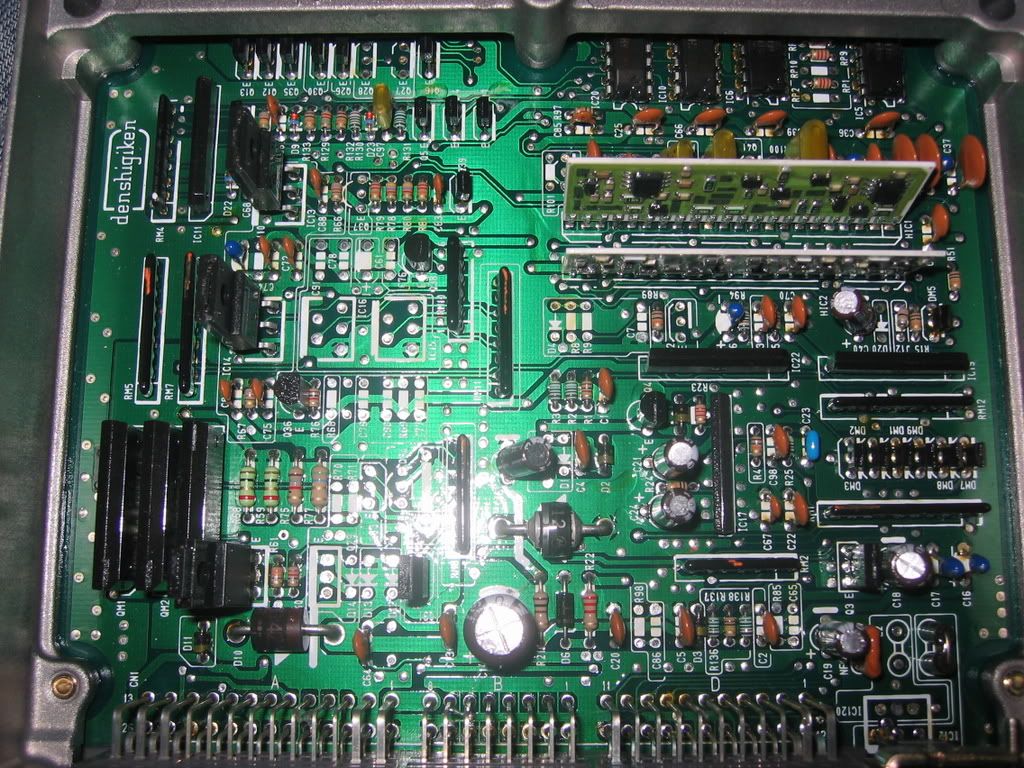

show us a close up picture of your ecu. Maybe there is more wrong than just the jumper.
Have you ran this ecu chipped before? I kind of feel like this ecu was chipped and had problems, so J1 was cut and the ecu sold.
I really question the chipping job... I have purchased countless Botched chipped ECU's, and all I had to do was clean the protective 3M film off the board, desolder all end-user soldered joints, refloat all of them, and the ECU worked fine afterwards! Most people don't take the time to brush or use a solvant to remove the thin waterproofing coat they put on the ECU and it makes it about 50x harder to solder it correctly. Also, scrutanize the installation of the ribbon cable for the ostrich, and use an ohmmeter to test it's connection to the socket, and all components installed with the chipping job. If you use a base .cal, with no modifications, and all sensors disable, KoEo you should see no solid CEL; if you do see a solid CEL: check connections make sure your ostrich is licensed make sure the upload of base rom and calibration goes through successfully check chipping job Solid CEL points towards hardware: either ECU or missing/switched sensors.

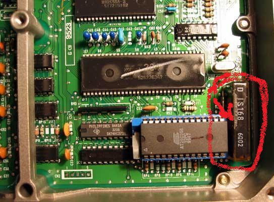

the ecu hasnt been chipped before. it was in factory condition before i bought the ostrich and hulog. here is pictures of my ecu. http://i38.photobucket.com/albums/e106/ ... G_2030.jpg http://i38.photobucket.com/albums/e106/ ... G_2031.jpg
Your missing like half the chip kit there. Here is what it should look like. Image
Your missing both capacitors, resistor, and logic chip.

if you look at the first picture on the link http://www.superhonda.com/tech/honda_ec ... mming.html you can see the ting marked on the attachment picture i do not have that. and the first picture on the link was when he had not touched anyting.
