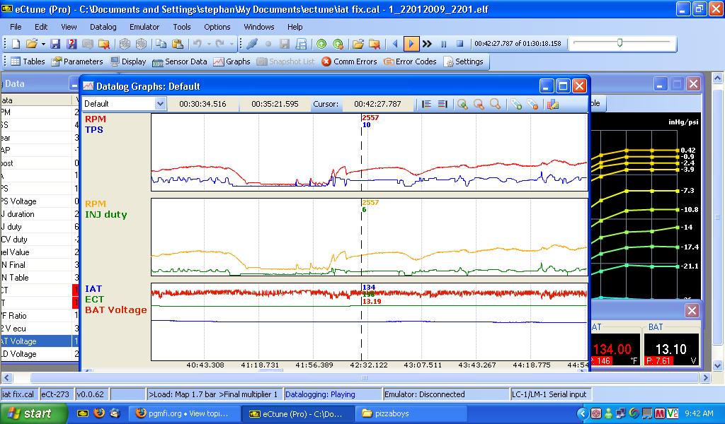

From datalog, Battery Voltage fluctuates, The lowest and highest i seen is like 11.75 and highest 13.6 These are just the peaks, it might not be at one rpm 12.9-13.7 At idle. IS this normal? anyone have a map and datalog so i can see how my car sensors supposed to be?

no pulleys i posted a screen shot tell me if this is normal please

how does the battery voltage look? messed up? also how much should the battery voltage read?

alternator may be bad under WOT voltage drops to 12V's How bad would this affect AFR?

Lots. battery voltage should be 14 or so

no wonder im getting hell to dial in afr at part throttle thanks everyone :o
horrible bad
