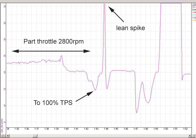

I did some runs today and am happy to report that I have the problem almost entirely under control. First I set the fuel cut delay to 800ms. I also set the tip-in to 5%. In order to get no stumble from part throttle to 100% during low rpm the tip-in seems to work best around 20 - 40% but this causes breakup during shifting.. I lowered the tip-in down to 5% which works great during high rpm shifting but I get breakup punching it from part throttle to 100% WOT.. This is no big deal to me though as there really is no reason to be doing this. If anyone is interested in picking through my logs here they are. The jpg is a snapshot of the LM-1 o2 log. It shows the lean spike during part throttle to full throttle which only lasts about 200ms at its peak. enough to make the car misfire once or twice. For some reason the ectune logs do not pick this up. I think this is due to my out put refresh rate on the lm-1 unit. If I would have thought about it I would have it set higher before I logged. I am happy with the way things are now. Thanks for everyones input. Unfortunately I broke a ball joint on my last run so thats it for a few days.
