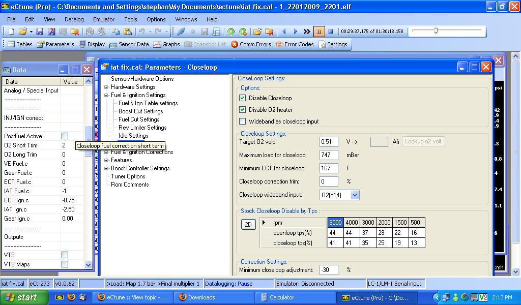

I once checked wideband as closed loop input but i press cancel.... dont know if its related
