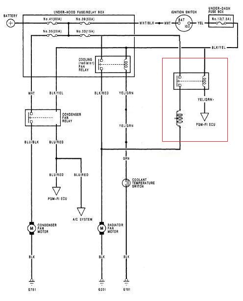

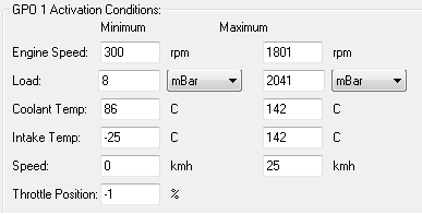

I use the fan control through a GPO in addition to the original mechanical switch. The point is to have the ECU activate my fan relay when driving at slow speeds or while standing still if ECT goes above 86c. The relay turns on the fan at reduced speed (almost silent) through a big 2-3 ohm resistor. It works amazingly well. The fan comes on earlier than normal when you come up to a red light, coming into the pits, or whatever. And even at reduced speed coolant temp never goes high, it´s just nice and stable. I highly recommend it :) /Allan

post diagram please

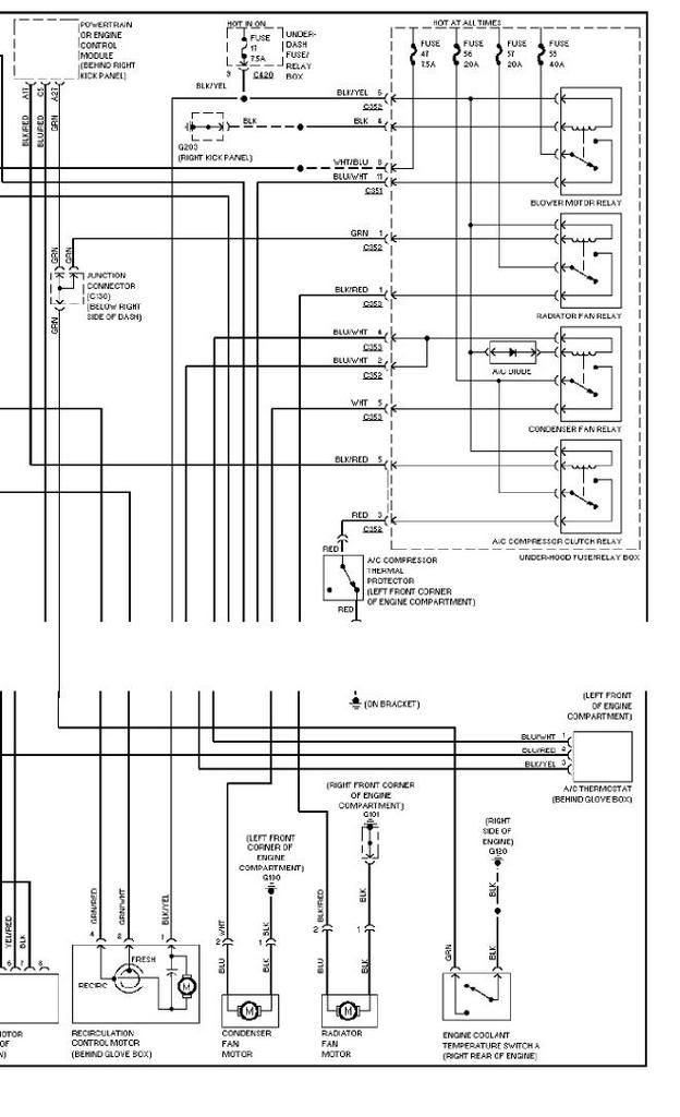

first pic below off of the Helm's Manual for 88-91 Civic the A12 connection is not drawn on the original diagram so i added a wire for it towards pin A12. Image this diagram below for 92-95 Civic / Helms repair manual. Image below diagram for 96-97 Civic, for OBD2A cars, FANC is pin A27. Image
newb a.k.a clyde(pgmfi.org)
See attached - my ECU-controlled-low-speed-fan-control addition. :) The \"coil\" drawing below the relay is a 2-3 ohm big ass power resistor. /Allan

Bindegal wrote:See attached - my ECU-controlled-low-speed-fan-control addition. :) The "coil" drawing below the relay is a 2-3 ohm big ass power resistor. /Allan
nice mod! thanks for sharing. :) how many watts is that resistor? is it the ones in white rectangular packages such as these ones below? Image
I think that depends on what kind of air flow you can get for the resistor. It has to dissipate a lot of watts. I used one in an aluminum housing that I could attach to the shock tower to help get rid of the heat. No problems so far. /Allan

I have a crankcase vacuum pump (really a GM smog pump) to pull fresh air through the crankcase that I did the same thing with. Since it would burn up and draw a lot of current to run continuously, I used the radiator control to operate the low speed so it doesn't come on until coolant temp = 80* F. That way it doesn't pull unnecessary load on the battery on a cold morning. The high speed is activated by GPO and engages at X rpm and load for wot operation only. The radiator fan is operated off another GPO that comes on at 400 rpm and cuts off over 60 mph. Everyhting is automatic now. Unfortunately all the aux outputs are used up. I bought this 2 ohm resistor from digikey - part# L100J2R0E-ND. This is a 100 watt long resistor, but stays within acceptable temp for a load that would otherwise pull 18 amps or so. The running amperage of the motor must be measured before determining the required resistance.
