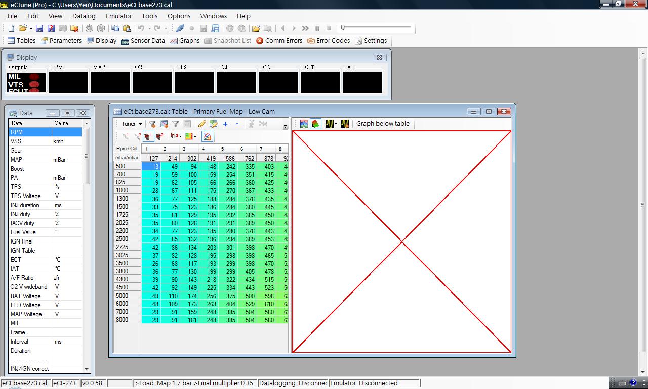

Hello, First of all, thanks for the great deal on the Pro version! I got my registration string and pasted the xml file under the ectune directory. I made a basemap and see the base map. It seems to me that the fuel map is not right (with a reg x)? Granted, this is a Visa CHINESE - may have something to do with it. I will install eCtune on a English Vista if this is the case. Thanks for the help! Derek

LOL! I thought so! Thanks for the reply Calvin! I will most likely get it installed on a English XP instead! Would the license.xml work on another laptop or would I need to send in the registration request again? For kicks and grins - here's the error message that was listed.. I believe it has something with \"JIT\" Some Chinese too.. lol! &#22914;&#38656;&#21483;&#29992; Just-In-Time (JIT) &#20597;&#37679;&#30340;&#35443;&#32048;&#36039;&#26009;&#65292; &#35531;&#21443;&#38321;&#26412;&#35338;&#24687;&#32080;&#23614;&#34389; (&#32780;&#38750;&#36889;&#20491;&#23565;&#35441;&#26041;&#22602;) &#30340;&#36039;&#35338;&#12290; ************** &#20363;&#22806;&#29376;&#27841;&#25991;&#23383; ************** System.NullReferenceException: &#20006;&#26410;&#23559;&#29289;&#20214;&#21443;&#32771;&#35373;&#23450;&#28858;&#29289;&#20214;&#30340;&#22519;&#34892;&#20491;&#39636; &#26044; e&#146;8f1rd1&#140;q&#134;l&#149;&#159;v&#152;t&#158;.685kftcv7&#158;&#150;2et&#150;&#138;j&#155;.&#149;&#152;&#154;&#135;&#135;&#139;�&#152;&#150;&#149;() &#26044; e&#146;8f1rd1&#140;q&#134;l&#149;&#159;v&#152;t&#158;.685kftcv7&#158;&#150;2et&#150;&#138;j&#155;.OnPaint(PaintEventArgs ) &#26044; System.Windows.Forms.Control.PaintWithErrorHandling(PaintEventArgs e, Int16 layer, Boolean disposeEventArgs) &#26044; System.Windows.Forms.Control.WmPaint(Message& m) &#26044; System.Windows.Forms.Control.WndProc(Message& m) &#26044; System.Windows.Forms.ScrollableControl.WndProc(Message& m) &#26044; System.Windows.Forms.ContainerControl.WndProc(Message& m) &#26044; System.Windows.Forms.UserControl.WndProc(Message& m) &#26044; System.Windows.Forms.Control.ControlNativeWindow.OnMessage(Message& m) &#26044; System.Windows.Forms.Control.ControlNativeWindow.WndProc(Message& m) &#26044; System.Windows.Forms.NativeWindow.Callback(IntPtr hWnd, Int32 msg, IntPtr wparam, IntPtr lparam) ************** &#24050;&#36617;&#20837;&#30340;&#32068;&#20214; ************** mscorlib &#32068;&#20214;&#29256;&#26412;: 2.0.0.0 Win32 &#29256;&#26412;: 2.0.50727.1433 (REDBITS.050727-1400) &#31243;&#24335;&#30908;&#22522;&#24213;: file:///C:/Windows/Microsoft.NET/Framework/v2.0.50727/mscorlib.dll ---------------------------------------- eCtune &#32068;&#20214;&#29256;&#26412;: 0.0.2.1 Win32 &#29256;&#26412;: 0.0.2.1 &#31243;&#24335;&#30908;&#22522;&#24213;: file:///C:/Program%20Files/eCtune/eCtune.EXE ---------------------------------------- System &#32068;&#20214;&#29256;&#26412;: 2.0.0.0 Win32 &#29256;&#26412;: 2.0.50727.1433 (REDBITS.050727-1400) &#31243;&#24335;&#30908;&#22522;&#24213;: file:///C:/Windows/assembly/GAC_MSIL/System/2.0.0.0__b77a5c561934e089/System.dll ---------------------------------------- System.Windows.Forms &#32068;&#20214;&#29256;&#26412;: 2.0.0.0 Win32 &#29256;&#26412;: 2.0.50727.1433 (REDBITS.050727-1400) &#31243;&#24335;&#30908;&#22522;&#24213;: file:///C:/Windows/assembly/GAC_MSIL/System.Windows.Forms/2.0.0.0__b77a5c561934e089/System.Windows.Forms.dll ---------------------------------------- System.Drawing &#32068;&#20214;&#29256;&#26412;: 2.0.0.0 Win32 &#29256;&#26412;: 2.0.50727.1433 (REDBITS.050727-1400) &#31243;&#24335;&#30908;&#22522;&#24213;: file:///C:/Windows/assembly/GAC_MSIL/System.Drawing/2.0.0.0__b03f5f7f11d50a3a/System.Drawing.dll ---------------------------------------- startup_lib_net_2_0 &#32068;&#20214;&#29256;&#26412;: 2.0.0.0 Win32 &#29256;&#26412;: 0.0.2.1 &#31243;&#24335;&#30908;&#22522;&#24213;: file:///C:/Program%20Files/eCtune/eCtune.EXE ---------------------------------------- System.Xml &#32068;&#20214;&#29256;&#26412;: 2.0.0.0 Win32 &#29256;&#26412;: 2.0.50727.1433 (REDBITS.050727-1400) &#31243;&#24335;&#30908;&#22522;&#24213;: file:///C:/Windows/assembly/GAC_MSIL/System.Xml/2.0.0.0__b77a5c561934e089/System.Xml.dll ---------------------------------------- mscorlib.resources &#32068;&#20214;&#29256;&#26412;: 2.0.0.0 Win32 &#29256;&#26412;: 2.0.50727.1433 (REDBITS.050727-1400) &#31243;&#24335;&#30908;&#22522;&#24213;: file:///C:/Windows/Microsoft.NET/Framework/v2.0.50727/mscorlib.dll ---------------------------------------- System.Management &#32068;&#20214;&#29256;&#26412;: 2.0.0.0 Win32 &#29256;&#26412;: 2.0.50727.1433 (REDBITS.050727-1400) &#31243;&#24335;&#30908;&#22522;&#24213;: file:///C:/Windows/assembly/GAC_MSIL/System.Management/2.0.0.0__b03f5f7f11d50a3a/System.Management.dll ---------------------------------------- System.Windows.Forms.resources &#32068;&#20214;&#29256;&#26412;: 2.0.0.0 Win32 &#29256;&#26412;: 2.0.50727.1433 (REDBITS.050727-1400) &#31243;&#24335;&#30908;&#22522;&#24213;: file:///C:/Windows/assembly/GAC_MSIL/System.Windows.Forms.resources/2.0.0.0_zh-CHT_b77a5c561934e089/System.Windows.Forms.resources.dll ---------------------------------------- Accessibility &#32068;&#20214;&#29256;&#26412;: 2.0.0.0 Win32 &#29256;&#26412;: 2.0.50727.1433 (REDBITS.050727-1400) &#31243;&#24335;&#30908;&#22522;&#24213;: file:///C:/Windows/assembly/GAC_MSIL/Accessibility/2.0.0.0__b03f5f7f11d50a3a/Accessibility.dll ---------------------------------------- System.Configuration &#32068;&#20214;&#29256;&#26412;: 2.0.0.0 Win32 &#29256;&#26412;: 2.0.50727.1433 (REDBITS.050727-1400) &#31243;&#24335;&#30908;&#22522;&#24213;: file:///C:/Windows/assembly/GAC_MSIL/System.Configuration/2.0.0.0__b03f5f7f11d50a3a/System.Configuration.dll ---------------------------------------- System.Security &#32068;&#20214;&#29256;&#26412;: 2.0.0.0 Win32 &#29256;&#26412;: 2.0.50727.1433 (REDBITS.050727-1400) &#31243;&#24335;&#30908;&#22522;&#24213;: file:///C:/Windows/assembly/GAC_MSIL/System.Security/2.0.0.0__b03f5f7f11d50a3a/System.Security.dll ---------------------------------------- System.Web.Services &#32068;&#20214;&#29256;&#26412;: 2.0.0.0 Win32 &#29256;&#26412;: 2.0.50727.1433 (REDBITS.050727-1400) &#31243;&#24335;&#30908;&#22522;&#24213;: file:///C:/Windows/assembly/GAC_MSIL/System.Web.Services/2.0.0.0__b03f5f7f11d50a3a/System.Web.Services.dll ---------------------------------------- System.Deployment &#32068;&#20214;&#29256;&#26412;: 2.0.0.0 Win32 &#29256;&#26412;: 2.0.50727.1433 (REDBITS.050727-1400) &#31243;&#24335;&#30908;&#22522;&#24213;: file:///C:/Windows/assembly/GAC_MSIL/System.Deployment/2.0.0.0__b03f5f7f11d50a3a/System.Deployment.dll ---------------------------------------- System.Deployment.resources &#32068;&#20214;&#29256;&#26412;: 2.0.0.0 Win32 &#29256;&#26412;: 2.0.50727.1433 (REDBITS.050727-1400) &#31243;&#24335;&#30908;&#22522;&#24213;: file:///C:/Windows/assembly/GAC_MSIL/System.Deployment.resources/2.0.0.0_zh-CHT_b03f5f7f11d50a3a/System.Deployment.resources.dll ---------------------------------------- Interop.MTSSDKLib &#32068;&#20214;&#29256;&#26412;: 1.0.0.0 Win32 &#29256;&#26412;: 1.0.0.0 &#31243;&#24335;&#30908;&#22522;&#24213;: file:///C:/Program%20Files/eCtune/Interop.MTSSDKLib.DLL ---------------------------------------- eCtune.XmlSerializers &#32068;&#20214;&#29256;&#26412;: 0.0.2.1 Win32 &#29256;&#26412;: 0.0.2.1 &#31243;&#24335;&#30908;&#22522;&#24213;: file:///C:/Program%20Files/eCtune/eCtune.XmlSerializers.DLL

Changed from Vista Chinese to XP English. Worked without any hiccup. Kudos to eCtune with prompt support and re-issuance of new registration! Derek
Your license is not valid
vista/xp on same laptop works with the same license.. right allan?
I personally experience the same screenshot a whie ago, I think it had something to do with reloading the last tune and not having the right license. Remember I posted you a bug on this ?
On my company HP, the same license file worked in both XP and Vista (bootmagic). Exact same setup on my own T61 - required a different license. Same exact bootmagic setup for dualboot, so I´m not so sure what caused this. The big red X etc. I have seen before. At that time, it was related to .NET . If I removed ALL .NET components and versions and updates, then re-installed eCtune, the installer would get the right .NET stuff, install it and everything worked again. As for Vista - when ever in doubt, try to disable UAC. This seems to solve most of the annoying issues with Vista. Sad but true. /Allan
i don't see how in the world a software change could modify a _hardware id_
Well it could. On XP, it doesn't matter if you have a memory card inserted. On Vista, hardware ID change.
Ahh; yeah for some reason, this is the first time it has ever happened; when I installed my 2GB memory upgrade for my tablet, I had to reactivate.... MS must be constricting down a little more these days.
Got the X bug. I just had a new .cal opened and it was showing the low cam fuel table. 1. Click the fuel table to make it active. 2. Press F4, you should have a view in % of the fuel table 3. Press F8 to switch to high cam 4. Press F7 to go back to low cam (boom)
