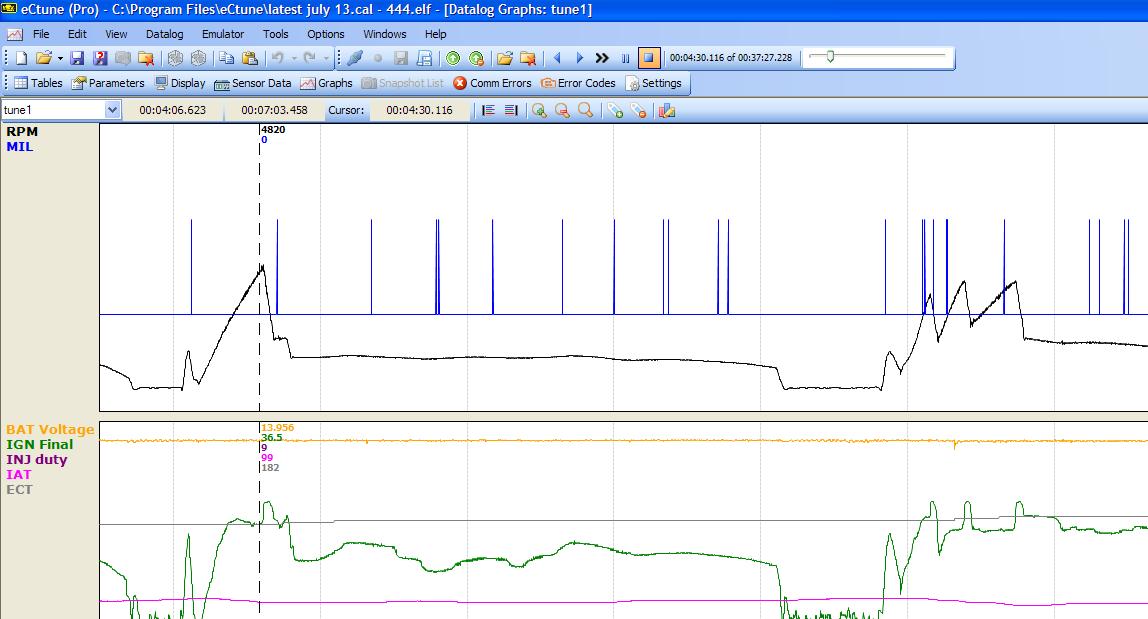

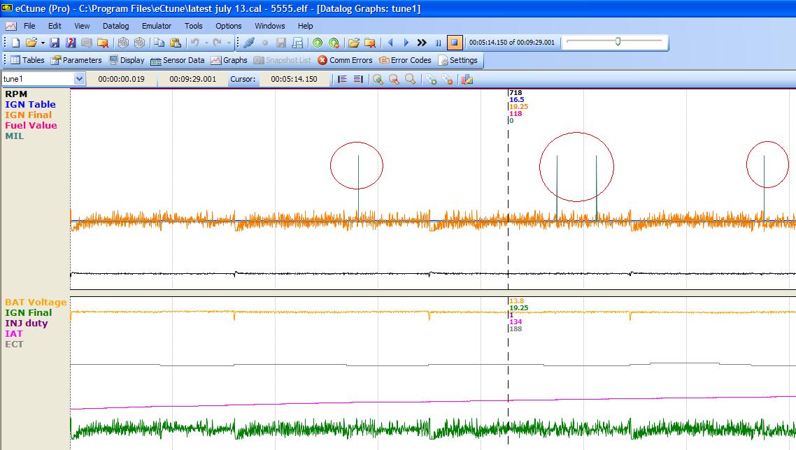

With the r15 release I get random flashes of this light. Idle or WOT it will happen....seems more so with WOT though. I've been most impressed with ectune as a whole. Can't say enough good things about it, nice job :D .

calvin wrote:try to start your calibration from scratch..
ahh....that would be it. no more flashing, thanks.
it solved it?

yes it did. In the datalog graph the MIL is now just a flat line :D
can u send the old cal and the new one for me?
