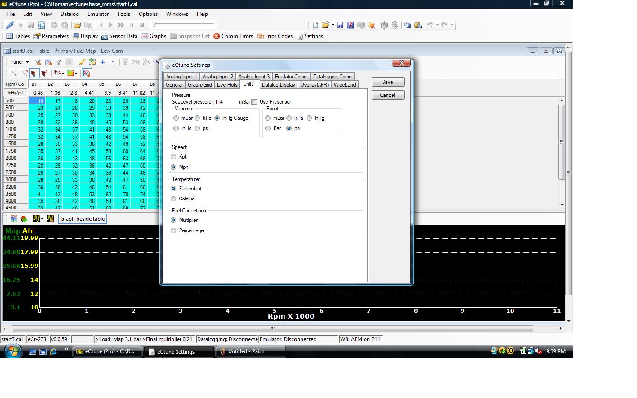

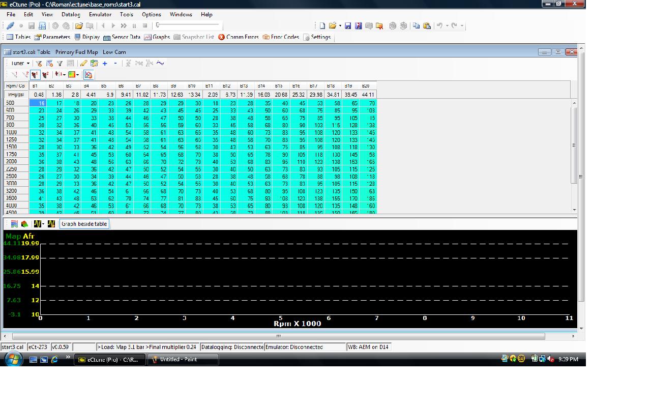

screen shots
messed up vacuum/boost
settings screen
settings screen
sealevel should be 1024mbar not 114 mbar;)
