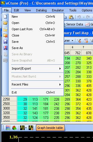

Hey Guys, I am facing a problem when I tried to burn a 27c256 eprom with new configuration tuned with ECtune. I used Chrome as performance tune and started ECTune today. Everything got OK during the calibration and even better performance comparing with Chrome tools. BUT, I could not save .cal file as binary file... when you choose FILE, than ECTune didn't list SAVE AS BINARY.. it is not allowed (see picture attached).. wondering why this is happening. Also, I tried to burn a chip using Willen Pro but no sucess also... I notice that .cal has 9kb and normal .bin generated by Chrome have 32kb. so I got check engine using .cal How can I generate a binary file using .cal file? OR.. Is there any other way to burn a chip using .cal? PS: I have ECtune PRO version 0.0.2.2 R8 Thanks

No way to burn chips with Pro version. You must use a ostrich
