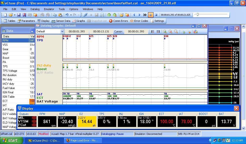

I have a problem with Consistant Idle ARF. At Idle around 850rpm The Afr Fluctutates The Battery Volt is the Same ECT and IAT Are the Same Goes 14.48-14.98 AFR
AFR
AFR

man..thats such a small blip in the afr..that happens for a split second..and its at idle or vaccuum..its nothign to worry about. there are other factors that could make that happen too

what are some other factors to consider? How consistant should the afr be?

occasional misfire and or ecu shifting timing to compensate -> afr twitch

You will never get it to be 100% rock solid. It is not Calvin's, eCtune's, or your fault. I have tuned vehicles on about 15 different types of software and I ALWAYS see small fluctuation in afr's at idle. Do not get me wrong, a small blip from 14.4 to 14.8 is ok, but if it is jumping a whole point or something more extreme then it is usually a compensation table you need to adjust.
