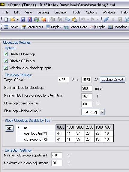

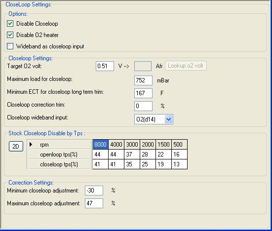

Ok, so I'm still confused. I attached a screenshot. Under \"Stock Closeloop Disable by Tps\", lets say I'm driving at 2500rpm, in the table it looks like if my tps is between 28-38(2000-3000rpm) I'll be in openloop? But then, underneath it, it says if my tps is between 25-35, I'll be in closed loop? Can some please thoroughly explain this to me? How can I just not use the tps function and run off the load value? Thanks
for example, at 3000rpm it stops closed loop above 37% tps, and it starts again under 35% tps. Everything in between will be interpolated.
And what about 36% tps @ 3000rpm? Is it in or out closed loop then? :D
crx303
Posts: 55
Joined: Thu May 03, 2007 3:45 pm
Post by crx303 »
out if you are decellerating. in if you are accellerating With interpolation Gaskleppie means between the RPM's
Not to bump an old thread but I've never successfully got closed loop to work, I haven't spent more than a few min messing with it each time and I'm sure its something I am doing wrong. I understand most of the values and how the open / closed loop % disable works I don't really understand the correction trim value, mine was auto set @ -80% I've attached a pic of my closed loop settings I think my correction settings are two narrow. Any insight or tips to help me get this working? I think it would be nice to send a customer off with this enabled.
