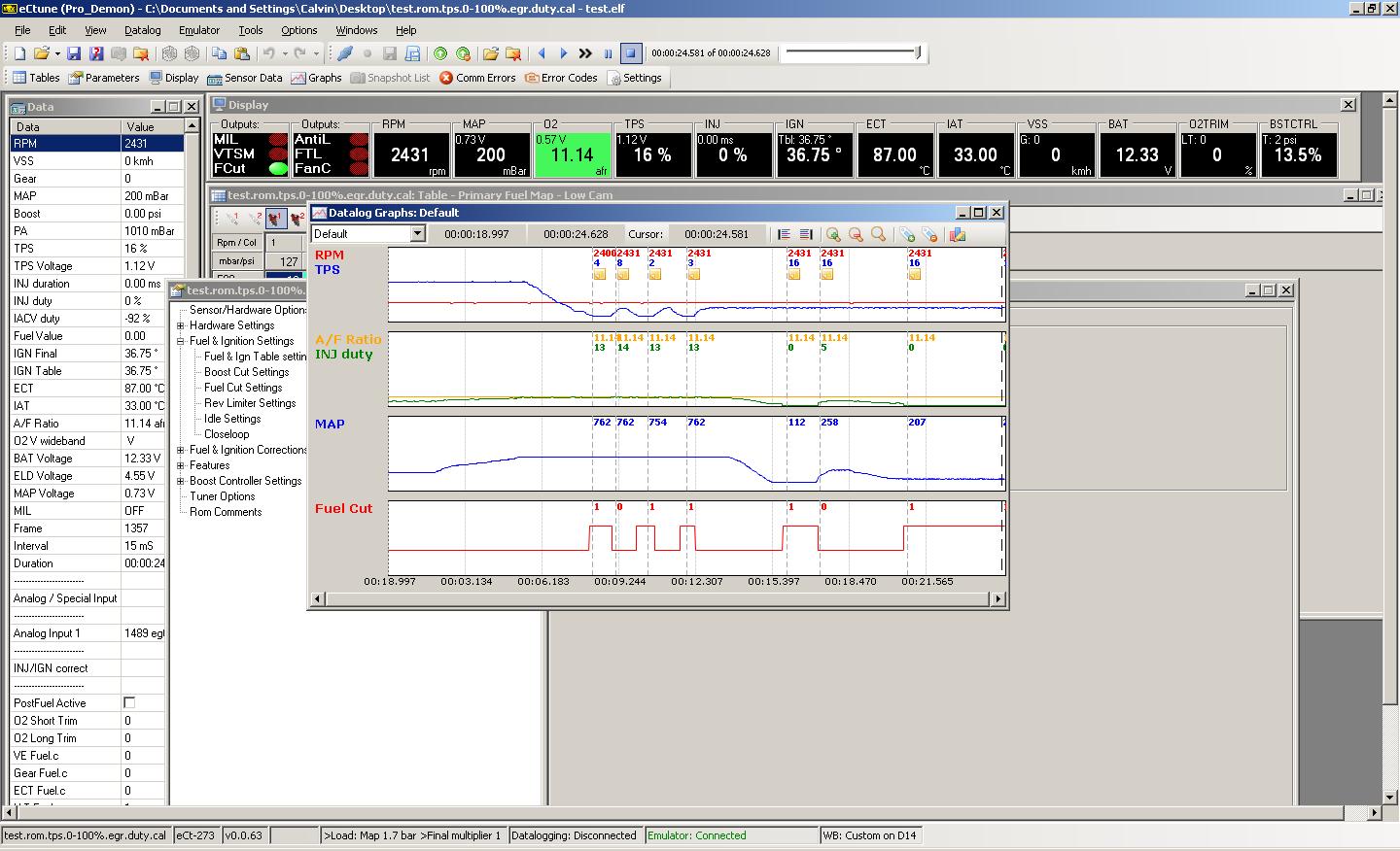

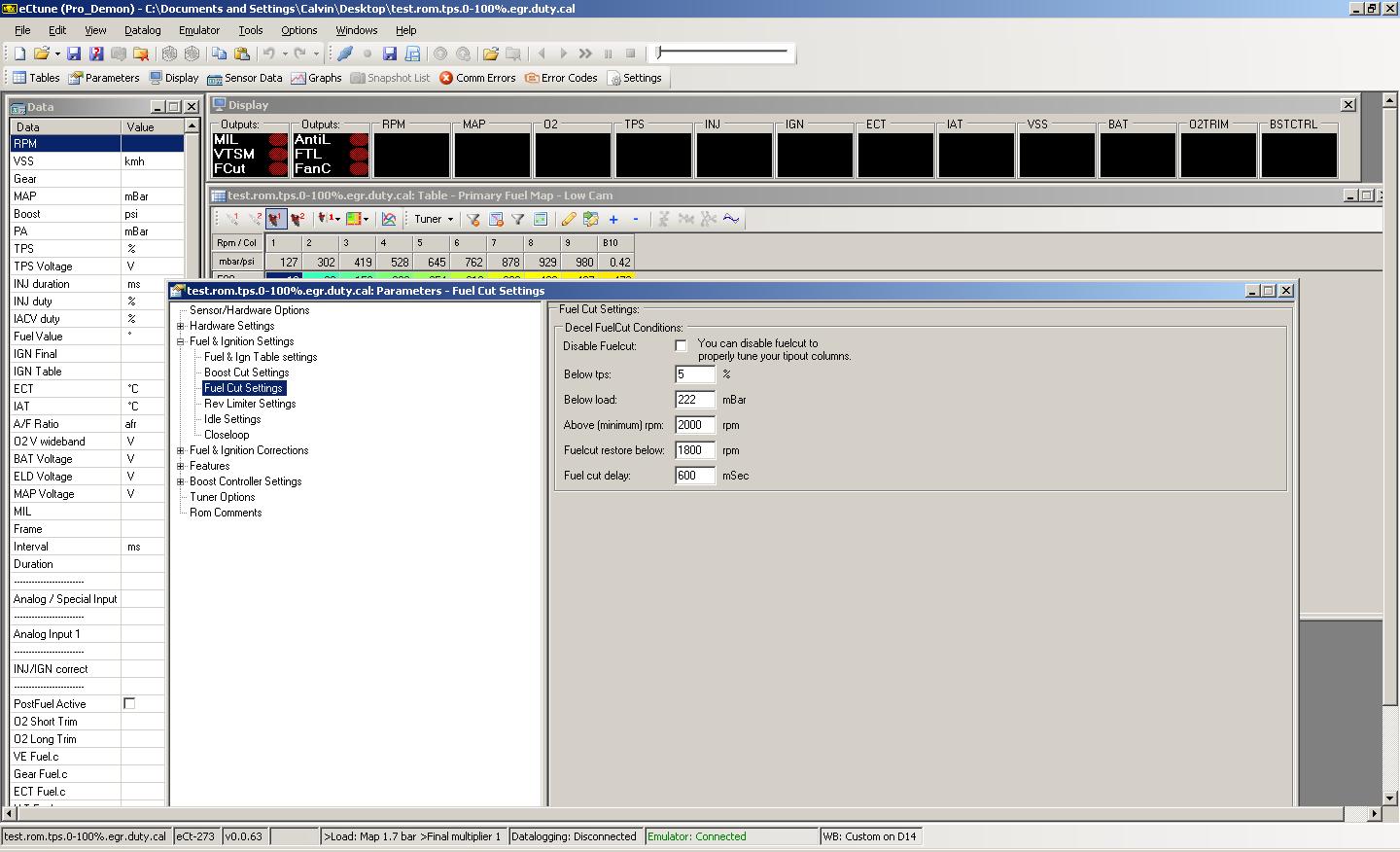

Guys.. I tested it onces again. Attached you will find cal and log file(with comments) Fuelcut Details: Rev limit fuelcut: Kills injectors does not set inj duration to 0 TPS fuelcut: kills injectors does not set inj duration to 0 Mbar fuelcut: kills injectors and set injector duration to 0, fuelcut becomes active after the fuelcut delay(default 600 mSec) -If tps is above min tps for mbar fuelcut, Fuel will be cut if mbar drops below load fuelcut. -If tps drops below tps for fuelcut, fuel will be cut. Both condition the min rpm for fuelcut has to valid(e.g. above 2000 rpm) Fuel will be restored if rpm is below restore rpm I tested this with the current release. The rar file for demon and Pro users. i didn't test it with force update version. Everything will be updated tonight. Please see screen shots, cal, log file with comments. I verified with a stock p72 and p30 bin. Injectors cut off but injector duration is not 0, but injectors are disable. You can see this every nice on the engine sim or with a scope!! Thanks darren I can patch it that it's this way. but i rather leave it stock. Honda knows why they did this.
look at makers with comments. If you don't want to open log file look at markers and it's values in
settings
settings
DSMR wrote:Just use a stock ol P30 cal with this. PLX M300 wideband but it is not necesarry as it will show no fuel cut registering.. The ECU doesnt not have the 5V mod for the wideband so you can not see the full range through the ECU..
This log file clearly shows no fuelcut. I'll upload a new version on force update tonight so you can test again. Sorry. Maybe i mixed version up. The best try this one. http://websrv.ectune.com/eCtune.update. ... 5.2009.zip
