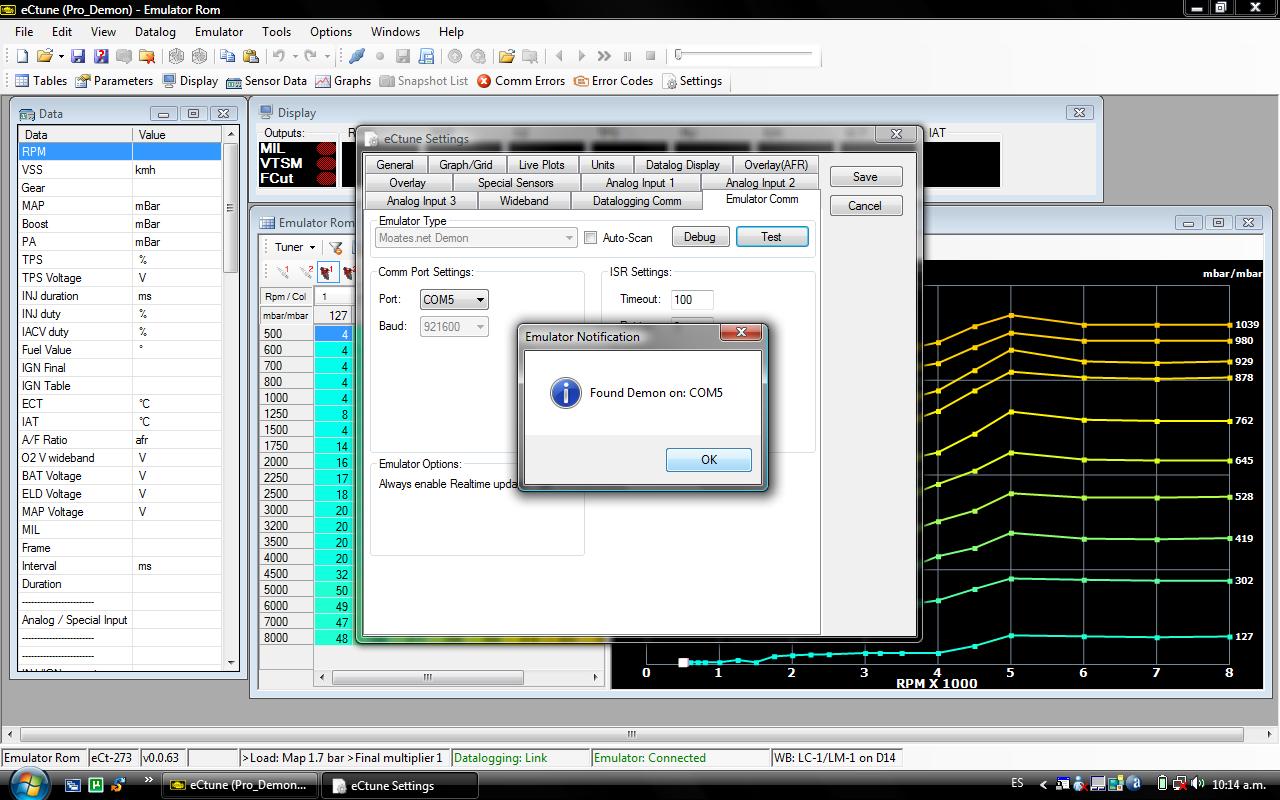

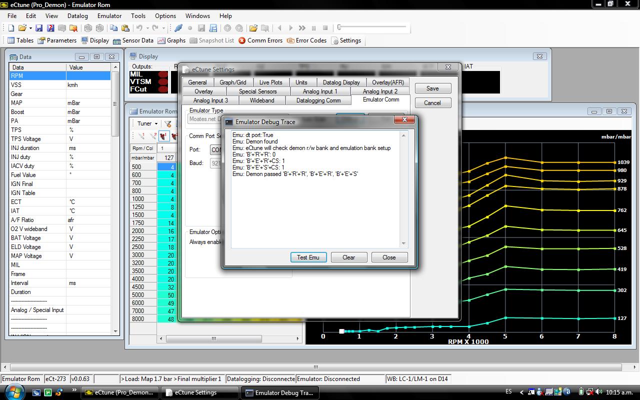

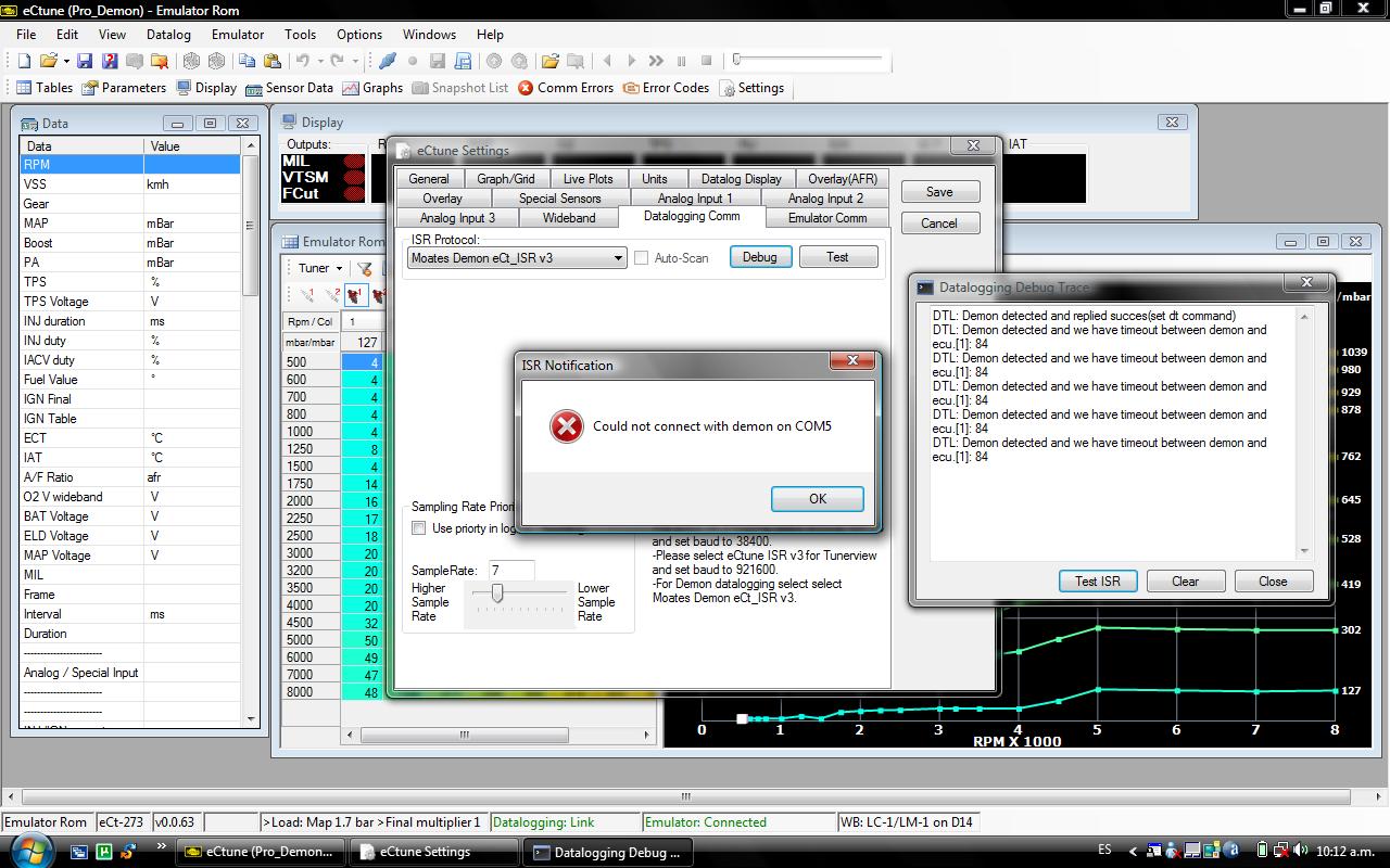

hello, i opened a thread in general comments, but here are my troubles, the car starts but only revs to 4000 rpm, and demon will connect to my laptop but wont datalog what can it be, i tested conection in settings and said demon found in com5
Somthing is wrong with your socket, or how the demon is plugged into the socket, sounds like the ECU isn't reading it. Double check everything..

well i tried as the wiki says and the leds are working normal, red led turns off when emulator is conected and the green one is flashing, could this be an issue with the license? i had another demon installed before this one, i un installed and put the new demon inside it do i need to send calvin the request for another licence to be there?
see wiki.ectune.com trouble shooting guide... problem between demon and ecu -cable -j12 -no rom uploaded http://wiki.ectune.com/index.php/Datalo ... on_version
