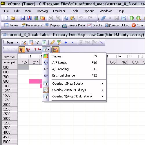

hopefully I remember this correctly since my brother was the one messing with it and just told me about it. He said he can't even click on the overlay tabs to look at it. They are all just grayed out.
you mean this?
overlay
overlay

yes, those tabs.
i do not believe the PRO version has the ability to use Overlay 1,2,3. IIRC only tuners and dealers have those options.

My PRO version allows me to see AFR logged in cells. If you enable cell trace, datalog, then open the datalog, open A/F Reading (F11) you will see the AFR in each cell that the trace touched.
