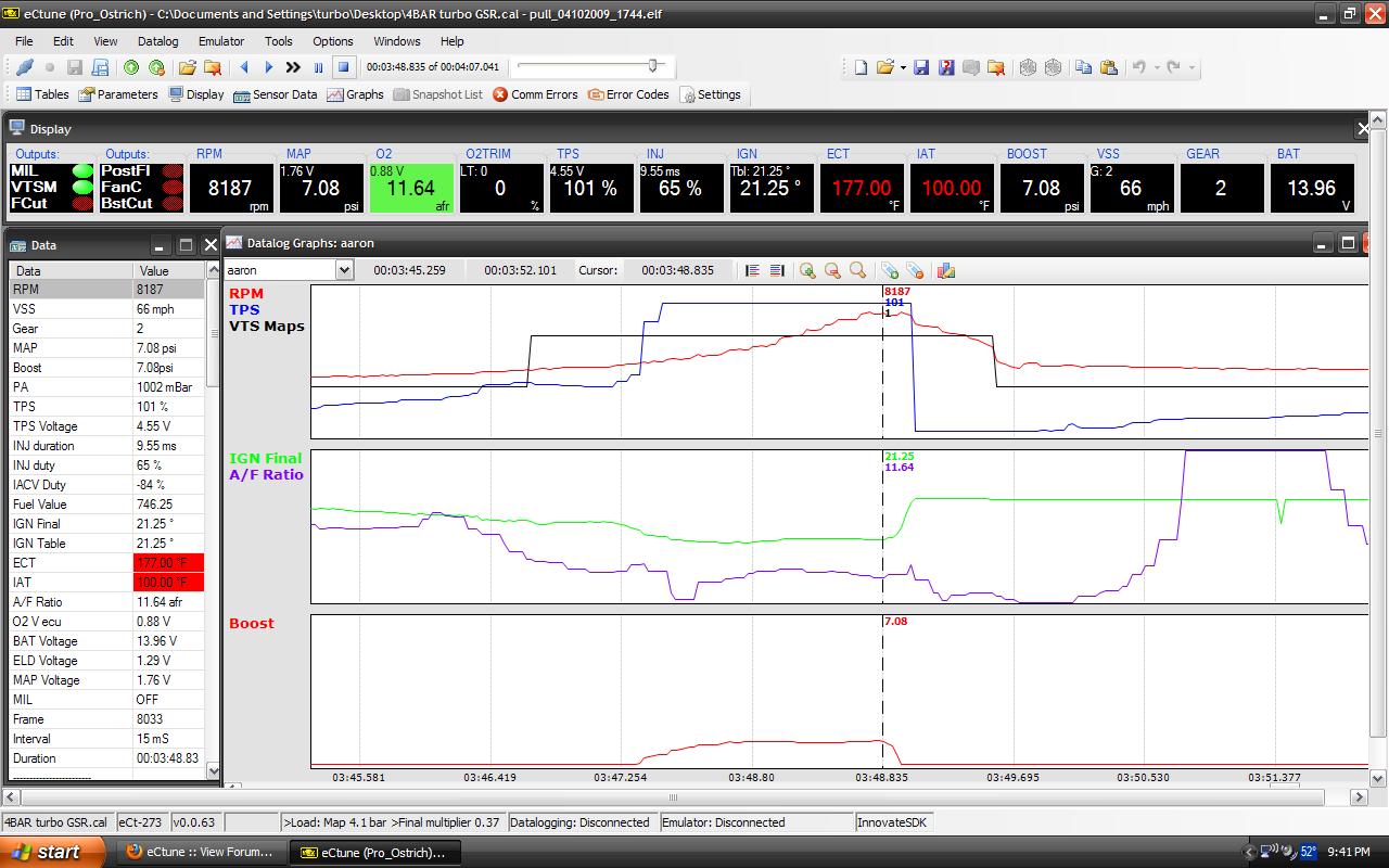

I recently upgraded to a 4bar map sensor and after creating a new CAL. for it and tuned everything and all.. but when I view my datalog graphs the boost line looks smaller than normal with same psi as before. The graph looks like its zoomed out even though its zoomed in all the way. Is it because of the scaling of the graph changed with the 4bar sensor? Edit:
2nd gear pull to 8100rpm.JPG (165.83 KiB) Viewed 2683 times
Yes it is because its now graphing 0 - 40+psi vs 0 - 10+psi like it used to with the stock map.
TopMountGSR wrote:Yes it is because its now graphing 0 - 40+psi vs 0 - 10+psi like it used to with the stock map.
thanks bro
