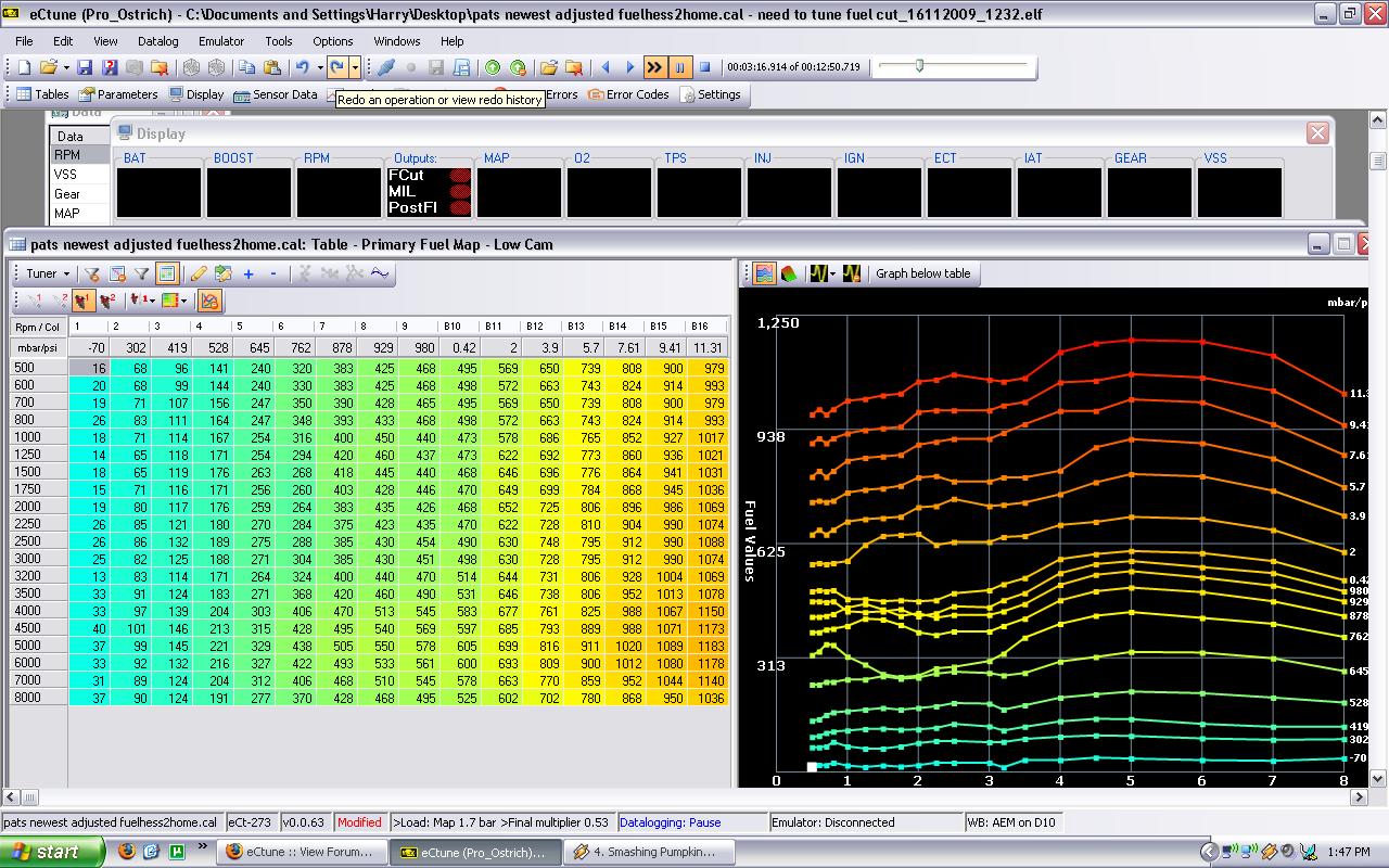

im getting popping and jerking on deceleration, wide band shows im dumping fuel. colume 1 is showing -70 mbar. how do i change that so i can get my fuel cut working properlly, i think that is my problem? any help is appreciated. here is a screen shot
ectune screen shot -70.JPG (247.56 KiB) Viewed 13014 times
your fuel cut can be set in the fuel cut parameters window. I disable fuel cut and tune tip out/deceleration. but to change that number, double click on it.

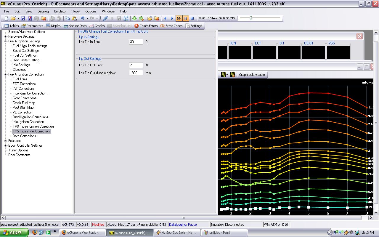

ok, i changed that number to 195 mbar, that is a round about reading on deceleration, but could you go a little more in depth about what you are saying about the tip out? here is a screen shot of my tip out. what should it be around? could you give me an idea of what it should be? thanx
tip out.JPG (166.36 KiB) Viewed 13009 times
you have to tune the engine and setup everything to where it needs to be. Datalog then analyze the data and make changes. Then go back out and datalog again until its where it needs to be. how do you know fuel cut is not working correctly? Have you datalogged to find out where its cutting or not cutting? Or are you just guessing? Tip out is the fueling the engine receives the second your TPS input decreases. TUNE IT. These problems you are having should go away once the software is setup properly to your engine. Read the help files if you are unsure of something and search the forum. There is an abundance of useful information here.

I was having the decel problem before so I don't know if doing a fresh install Will help you. Prety much you just have to tune it as I gather. Colume 1 on my map was at -70 and on decel my map is reading about 185 so I changed Colume 1 to 180 but I haven't had a chance to drive it since. As soon as I do I will post On how it did. If found a topic about it and calvin said that 90% of the time your decel Problems can be tuned in columes 1 and 2, so I'm going to give that a try, My map stays in colume 2 during idle and on decel so it think that the value for Colume 1 is my main problem, let me try that first and I will let you know before trying To reinstall.

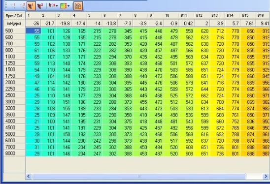

Fuel Cut.jpg (27.21 KiB) Viewed 12967 times

Post by 2bfi »
jpjackson, the set up is a JDM ITR engine with a Jackson Racing SC & LHT intercooler. Injectors are 440cc/min. Columns are in inHg. 1st column was not tuned for tipout. I can't really remember why I added to it. It might be to prevent jerking when the fuel cuts in and out during light throttle low rpm situations.
