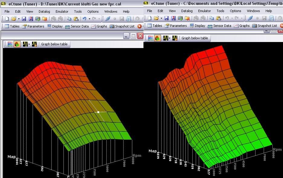

Its nice to see someone from KY using ectune, I am local, if you ever need anything please feel free to pm, txt, or call me. Ditch that fpr, they are a tuning nightmare as they can fluctuate. I would just use a stock fpr as most of the time that's all that is needed. I normally start with my imported tables that are smooth as glass, how smooth the car runs reflects this. Then use the overall trim to get a close air fuel at idle and raise and lower each row as needed while I'm driving to hit target afrs in different loads, then modify the fuel curves in the tables as needed. Also don't be afraid to run the 1st two columns a little rich, most cars like this and it makes the off and on transition of the throttle as smooth as glass. Sometimes you have to ignore the overlayed air fuel data in these columns. Give the car what it wants, I run my cars partials a bit richer than most, it loves it, produces more power, a lot smoother and gas mileage doesn't seem to be affected as much as you would think. Also if you are sticking with NA, I would use high res fuel and ignition tables. Its fun tuning one with them and its rewarding seeing how well they run in the end. Here is a picture of my fuel map, vs your fuel map, see the difference? You want smooth rows that hit a target air fuel safe range, not an exact target number for every cell, that leads to rough maps. Image Hope this helps,

I may have mis spoken, I adjust the entire column at once; column if you are looking at the fuel tables, row if you are looking at it in 2d/3d. I adjust across the entire rpm range vs one pressure. I normally grab columns 1-3 dial in idle, then individually grab 4, adjust it, move to 5, adjust it, etc.. then later on manipulate the fuel curves only as needed. I rarely have to do much to any curves when I start with my imported tables, depending on the size of the turbo normally decides how much fueling it wants in its fuel curve up top or cam profile for na cars. Start everything rich, I normally roughly get all of my partials to 13.5~ish and lean them from there, but not much. I used to tune partials @ ~16 afrs, now I think that's stupid and not worth the power and response loss for the marginal mpg gains from a 14.0-14.5 afr range. I've actually tuned two maps of each, put them on a switch, and hit it driving down the interstate, when you goto the leaner map, its like someone latched a trailer on the back of your car, bogs it back and requires more TPS % to go the same speed. Also, if you create an un needed fuel curve hump, below and above will be greatly effected creating a valley in the surrounding lines because there is so much fuel added in its neighbor. This is an easy way to tell whats right and wrong fuel curve wise; get used to the interpolate buttons, when you learn how to use them as they save loads of time. I like the 'interpolate column' button. Here is an example of how to use it, create a nice fuel curve for all 1 psi cells, then nice fuel curve for 40psi's cells, highlight 1-40psi, then interpolate column button, and bam; everything matches and is spaced evenly, all columns, 1-40psi.

Yes 100%, its funny, when I started with ectune, it'd run so smooth right off the bat, then I'd tune it for weeks and just wind up with a rough graph and a rough running car. Get used to tuning it from scratch, just makes you better in the end. I bet I have 10+ maps for one season for one car that I spend time with. Save copys, try this, try that, etc. Battery offset tuning is a must, use one of Bugermass's excellent methods, just unplug the big alternator plug while its running; then match the air fuels in from ~14v to now ~12v, then interpolate everything in between and 2d rich guess everything lower than 12v. There might still be a little fine tuning, loading the electrical system down, adjusting and so forth. The 2d button is an excellent tool, use this whenever adjusting anything that has this working button. Make everything as smooth as possible. If you will take the time to try one of my hi res fuel maps, I'll send you one, it would be an excellent start using my column adj method. Hope this helps, DK
