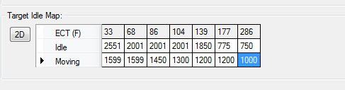

Thanks for the help. I'll try chance some values in suggested tables and see how it goes. By the way is there a target idle for cold start?
you can set the idle to what ever you want for warm up, go to idle settings and you can change it by ect, look at the srceen shot, it is how mine is set up, higher idle at a lower temp makes it warm up faster.
here is how i have mine set up
target idle map.JPG (20.13 KiB) Viewed 13071 times

jpjackson wrote:you can set the idle to what ever you want for warm up, go to idle settings and you can change it by ect, look at the srceen shot, it is how mine is set up, higher idle at a lower temp makes it warm up faster.
thanks once again 8)
