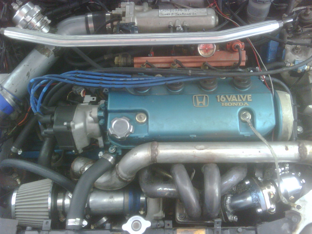

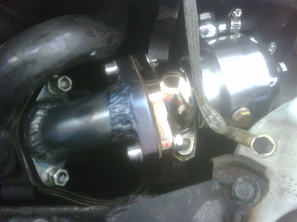

i am running a SOHC ZC, vitara set up, with a xspower t3, tubular manifold, 3 inch dp, new waste gate i just put on this weekend, its a ebay gate with a 4 lbs spring but it works great so far, once i start passing 55k it starts creeping 3-4 lbs, ive hit boost cut a couple of times. just curious with you being a tuner, have you tuned any setups like this? i know i need to do some port work on the waste gate primary, but i havent hade time to drop the turbo yet and i am waiting to have time because i am going to make a new down pipe.

unfortunately with that setup your going to have creep just with the design of the manifold and the poor wastegate placement.

what manifold and waste gate placement would be optimal and cant i compensate with the rpm duty comp tables?

The wastegate placement off the turbo manifold is terrible. the exhaust has to make a 180 to exit out so the reason your getting so much creep is the exhaust is going to go the path of least resistance in this case the turbine wheel which causes the creep. There is really no way to fix it with that manifold.

Also an ebay gate isnt helping your case. Who knows what that thing is good for.
well i guess i will be building my own manifold, thanks for the input guys, my waste gate i had before was a tial 38mm but the diaphragm was leaking and the price of a new one, i just got a new gate, and the valve housing on the eBay one is actually bigger than the tial, so i dont think the gate is my problem. when i did change the gate i did notice that there is alot of material in the primary that can be removed so i just think i need to do some port work and it would make it at least a little better. i mean the creep is manageable, my engine can handle it, she is fully built so. but also isn't the rpm duty compensation table there for managing creep, and boost dropping off at high rpm for small turbos? than was my main question on how to set that up, so if i put in negative values, wont that drop the duty cycle of the ebc to compensate for creep, and also closed loop? i am still playing with the fixed duty to dial in my look up tables so i havent messed with closed loop yet. thanks guys
