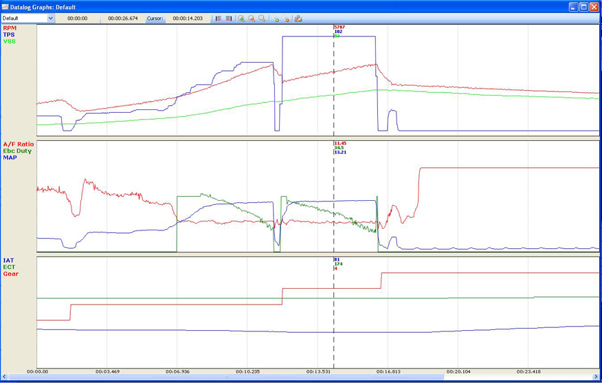

Reinstalled the boost controller last Sunday and did some testing. From the log it looks like everything is functioning correctly, although I still have a slightly leaking BOV which is preventing me from running low boost at waste-gate pressure. In forth gear the highest boost pressure I saw was 13.68psi @ 20% duty.
boost log.JPG (217.57 KiB) Viewed 16505 times
